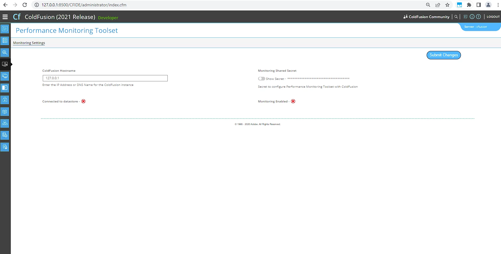

Have you actually confirmed that Performance Monitoring Toolset (PMT) is disabled? Check in the ColdFusion Administrator:
That is just for ruling out PMT. Because you mentioned it.

Yes. There are red Xs on there and the Debug pane has Performance Monitoring set to off.
