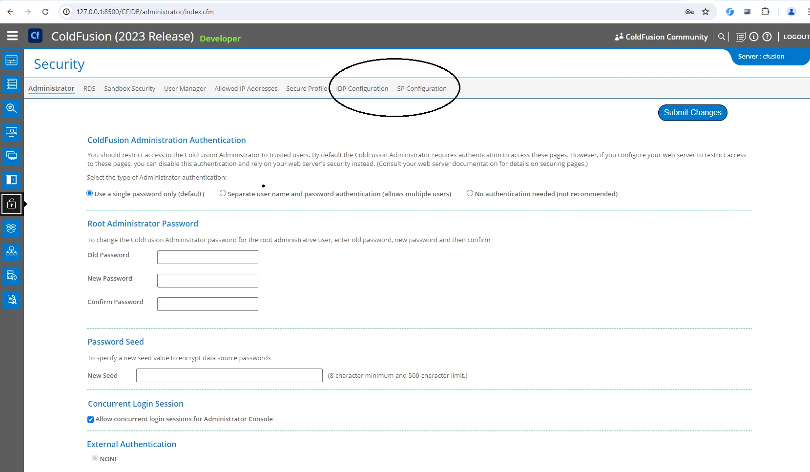

Did you follow the steps to configure the IDP/SP?
