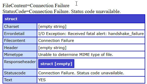

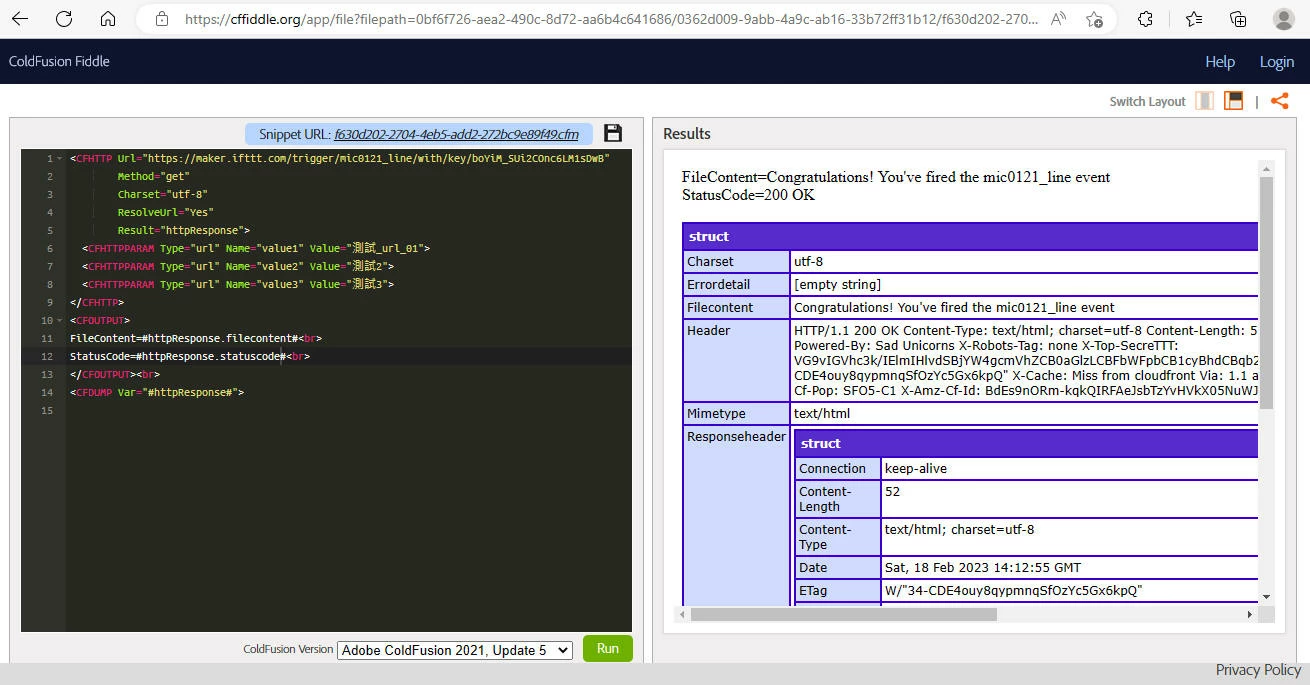

hui-huangk69511027
Feb 18, 2023 2:31 PM UTC
Thank you for your help, output cfhttp variable observation filecontent as shown in the figure, there is a "Connection Failure" error; But on Fiddle execution was successful, and appears "Congratulations ! You've fired the mic0121_line event"。
Charlie Arehart
Feb 18, 2023 6:26 PM UTC
Ok, thanks for that. And based on it, I'd say that a likely difference between your machine and the cfiddle is that you may not have updated that Java that underlies your cf. For more on how that's a common cause of such cfhttp failures, as well as how to go about resolving the matter (updating the Java cf uses), see my blog post on the cf portal:
https://coldfusion.adobe.com/2019/06/error-calling-cf-via-https-solved-updating-jvm/
