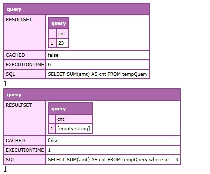

We are migrating from Cf2021 to CF2025.
One issue is that QoQ resuts shows empty string when is not data.

Result
The record count now is 1 for empty QoQ. It shoud be zero.
Any solution on this issue?

    “The record count now is 1 for empty QoQ. It shoud be zero.
    Any solution on this issue?”
    TL;DR Answer:
    This is not an issue. For all the ColdFusion versions before 2025, the QoQ record-count for SUM() was 0. That was incorrect. The 0 value contradicts modern SQL standards.
    Therefore, from ColdFusion 2025 onwards, the record-count has been changed to 1.
    As a workaround, you can add the GROUP BY clause to the SQL string.

    Mar 4, 2026 12:33 AM UTC
    I can see two issues:
    1. empty-string instead of null;
    2. record count of 1 instead of 0.
    The solution to 1. is to enable null-support. You can do so server-wide (on the page Server Settings > Settings in the ColdFusion Administrator) or application-wide (by defining this.enableNullSupport = true in Application.cfc).
    The issue 2. is a bit complicated. That is because the SQL,
    "SELECT SUM(amt) AS cnt FROM tempQuery where id = 3"
    is not entirely correct. The aggregate function, SUM(), applies to all rows. So, the where-clause should not be there.
