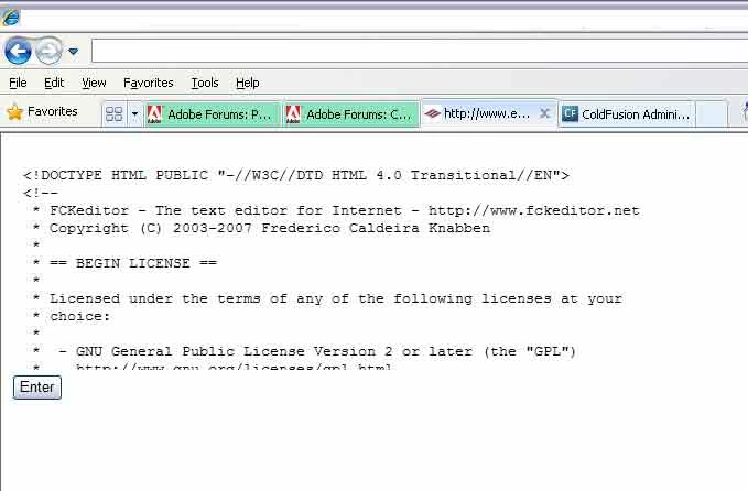

code....
<cfform name="form01" >
   <cftextarea enabled="yes" richtext=true name="text01"
     <cfinput type="submit" value="Enter" name="submit01"/>
</cfform>
what i get

    Issue Resolved.
    Website had an allowed mime type: *.* application/octet-stream
    After that was remove, it started working.

    I believe it has something to do with having more that 1 domain configured in IIS
    The code does work in 1 domain.

    Things to check:
    1. Do you have /CFIDE as a directory or virtual directory in all of your IIS sites?
    2. Can the browser access all required javascript files? Check what files are references in the HTML page your code generates and verify they all exist and are accessable.
    3. Does the browser have allow javascript to be run?
    4. Is the problem consistant across browsers?
    gmelansonAuthor
    December 18, 2009
    YES, i can access the cfide/administrator on all domains.
    YES, all good.
    YES
    Mostly, but safari is able to display the toolbar but gives javascript errors everywhere.
    PS. The component loads and works fine for one of the domains.
    December 18, 2009
    The code sample you've provided is incomplete and will not run.  The cftextarea tag is not closed.  Please the complete code for the page in question.
    gmelansonAuthor
    December 18, 2009
    my mistake when pasted on the code in
       <cftextarea enabled="yes" richtext=true name="text01"/>
    </cfform>
