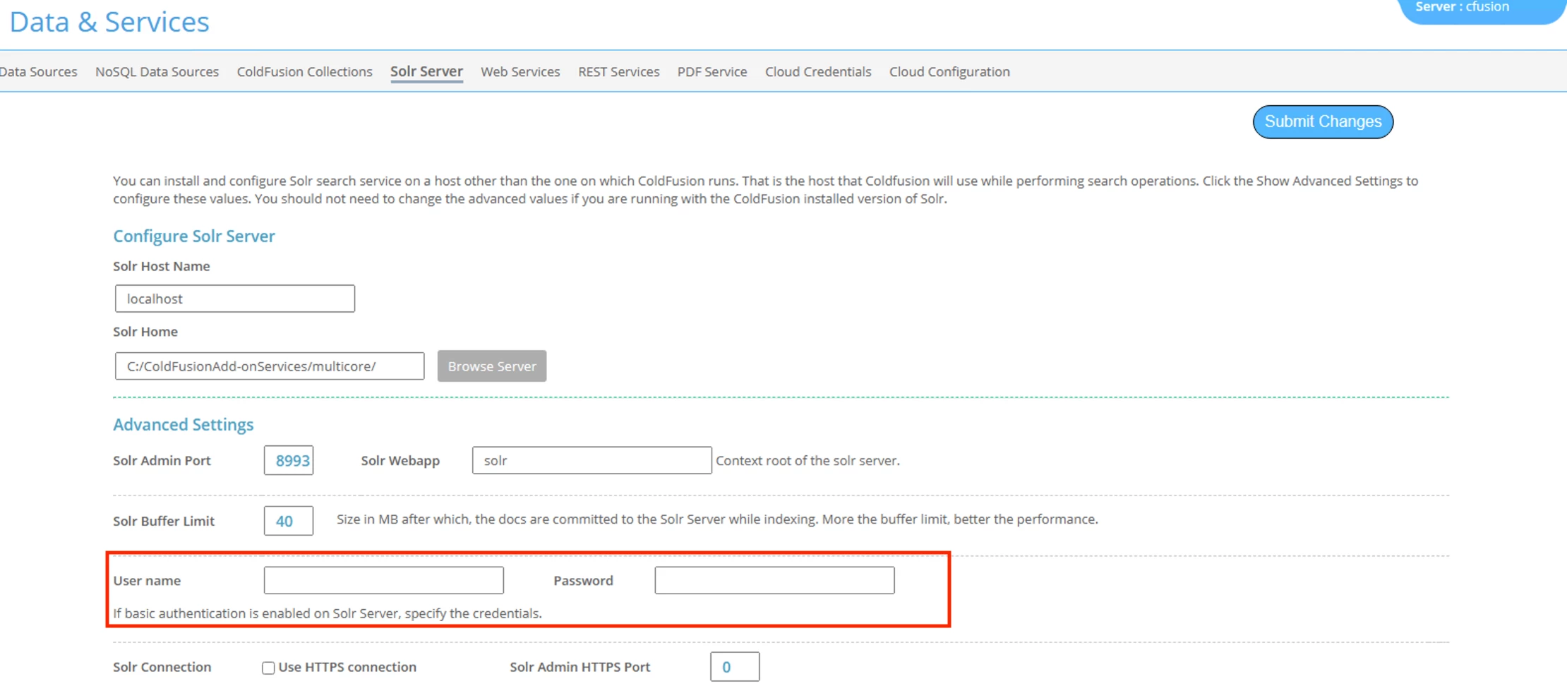

I am trying to use basic authentication with Solr and ColdFusion but am running into 2 issues.
I have done the following:
I tested logging into the Solr Admin: http://127.0.0.1:8993/solr/ using the credentials from the security.json file.  Anonymous access is now prohibited and I am able to authenticate.
Next I did the following:
  • Login to the CFADMIN.
  • Click the Data & Services icon on the left.
  • Click the Solr Server link in the top navigation.
  • Under Advanced Settings enter the credentials from the security.json file into the User name and Password fields.
  • Click the Submit Changes button.
Issue 1: The collections are not available in CFADMIN > Data & Services > ColdFusion Collections.  The error is:
Unable to retrieve collections from the Search Services.  Ensure that you have installed ColdFusion Search Service and it is running.
Issue 2: When I try to reindex collections the cfcatch detail and message are:
It has been configured as http://localhost:8993/solr.  SOLR server is not accessible.
So it seems like CFADMIN is not correctly authenticating to Solr.
Anyone have any thoughts?
Thanks in advance.

    It seems odd that ColdFusion would provide fields to enter credentials in the Data & Services > Solr Server tab if it was not supported, but maybe I'm missing something.
    A security scan at my organization doesn't like that Solr provides information without authentication at the address http://MACHINENAME:8993/solr/.
    So, would blocking port 8993 to external traffic with a firewall rule prohibit accessing that info?  I don't believe a can edit firewall rules because those are controlled by an Enterprise level IT group ant my organization but if this is the only solution perhaps I can request it.
