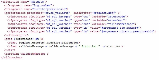

After applying CF 11 Update 5 on an update 4 web server
The following code
Throws an error that validateMessage is undefined at the cf return line
I rebuilt the connector and then the code throws a 500 error
Then I reverted the back to CF 11 update 4 and all is good
Does anyone know what happened here?

    Which database are you using?
    You may want to try requesting the fix in this bug report and seeing if it changes anything.
    Bug#3971083 - cfstoredproc - Last OUTPUT parameter - ColdFusion 11 Update 5
    Assuming all the vars are spelt correctly etc and match the sp.
