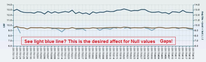

I have a SQL query (created by Oracle DB) that creates multiple cfchartseries using date as the column item and a number for the value. My issue is there are null values for the value field but I need it to plot

The Chart will display when I use the value ="0" but this pulls the line down instead of just STOPPING and then starting again when a numeric value is in the next record.

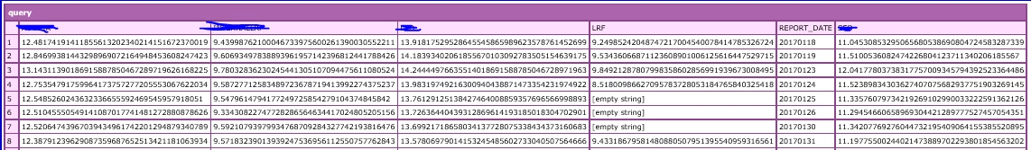

Here is my query

I suspect that the issue lies in how you are comparing values in your conditional.
Change this: <cfif qTrend.LRF gt 0>  to this: <cfif val(qTrend.LRF) gt 0> to force the value to numeric.  If it's blank (CF interprets database nulls as empty strings), then val('') is 0.
