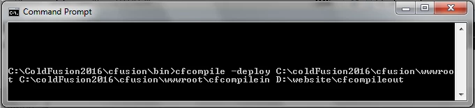

Copy the directory containing the files to be compiled, cfcompilein, to the root, C:\coldFusion2016\cfusion\wwwroot. The cfcompile tool is located in C:\coldFusion2016\cfusion\bin. So open MS DOS and change directories till you get to C:\coldFusion2016\cfusion\bin.
Then run
cfcompile -deploy C:\ColdFusion2016\cfusion\wwwroot C:\ColdFusion2016\cfusion\wwwroot\cfcompilein D:\website\cfcompileout
bobk07Author
Feb 10, 2017 3:38 PM UTC
I tried that suggestion and I still get the same error: “Webroot specified does not exist”
I would have thought that the "webroot" would be the path to the default website as defined in IIS, i.e., D:\website, but it doesn't like that either.
Maybe it needs to be defined somehow to Java, e.g.  in server.xml, just not sure how. I'm hesitant to touch anything though because CF is working fine and using the default website.
