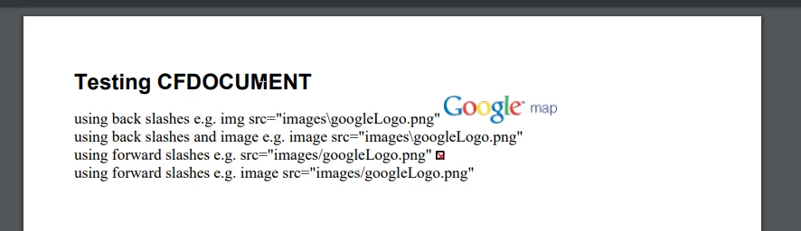

We have an old legacy application that we migrated from CF11 to CF2018. On migration I had noticed that pdfs were taking significant time to generate compared to the previous site/server version. Looking further I found Charlie's post regarding the localURL attribute setting. So trying this I have encountered some weird behaviour in that images/styles still don't load.
I ran the test code below:
<cfdocument name="pdfContent" saveAsName="test.pdf"  format="pdf" localurl="yes">
    <table width="100%" border="0" cellpadding="0" cellspacing="0">
      <tr>
        <td align="left">
          <font face="Arial, Helvetica, sans-serif" size="+2"><strong>Testing CFDOCUMENT </strong></font>
        </td>
      </tr>
      <tr><td colspan="6">
        using back slashes e.g. img src="images\googleLogo.png" <img src="\images\googleLogo.png"><!--- Works ---><br/>
        using back slashes and image e.g. image src="images\googleLogo.png" <image src="\images\googleLogo.png"><!--- Doesn't work ---><br/>
        using forward slashes e.g. src="images/googleLogo.png" <img src="/images/googleLogo.png"><!--- Doesn't work ---><br/>
        using forward slashes e.g. image src="images/googleLogo.png" <image src="/images/googleLogo.png"><!--- Doesn't work ---><br/>
      </td></tr>
    </table>
</cfdocument>
<cfheader name="Content-Disposition" value="inline; filename=test.pdf">
<cfcontent variable="#toBinary(pdfContent)#" type="application/pdf" reset="Yes">
and get the following output:
Edited: to include correct screenshot.
Things I am noticing:
Forward slashes vs backslashes make a difference. Coldfusion's documentation for cfdocument uses the forward slashes in their example, and this doesn't work.
and the <img> vs <image> tags make a difference.
Am I missing something simple here?

    s15, a few things:
    • the docs are flat wrong to use an image vs img tag. There is no such animal
    • the docs are also wrong to show / vs \, without clarifying the OS, and whether using localurl or not, because the difference matters.
      • On Windows, at least, with localurl=yes, it must be \ (since the call is made for a file on Windows).
      • Conversely, with localurl="no" (or if left to default to no), it must be / (since the call is made via an internal http call, using whatever web server is serving this cfml page, even though the request for the image is to a local file)
    I have confirmed this (on Windows) for CF2018, 2016, and 11. And I agree that both variants (localurl yes or no) should be able to work with either slash (on any OS).
    You could help others if you would file first a bug report (at tracker.adobe.com), reporting the doc mistake if an image tag, and to assert that it should clarify this matter of / vs \, depending on whether localurl yes or no (and depending on the OS).
    Then you would still more people to file a feature request there, asking Adobe to change CF so that it works with either slash.
    Finally, about your original need, to speed up your CFDOCUMENT processing, you didn't clarify: did the use of localurl help (when you used the img tag and the correct slash for your OS?)
    /Charlie (troubleshooter, carehart. org)

    Hey Charlie
    Thanks for your follow up! Sounds good I'll definitely file a bug report and also the other reports as you mentioned. I'm glad it wasn't something simple I was missing, as it was driving me nuts for the amount of time I spent on this.
    With regards to the original requirement, enabling localurl actually did help to improve the cfdocument processing, so I guess Adobe did end up doing something right in that respect.. except I had to go through and alter all the img/style tags to utilize a fully qualified domain reference, eg. https://oursite.com/images/image.jpg for them to show up in the pdf.
    Edit: Bug submitted - CF-4208140
