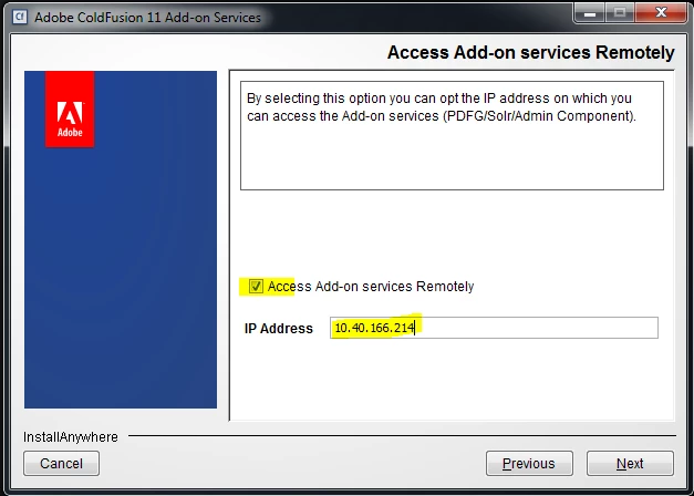

    1. When installing PDF Add service, there is a screen comes where it is asking you to Access Add on service remotely, add the IP address of the server where you're installing it.
    2. Finish the installation and make sure it's service should be running.

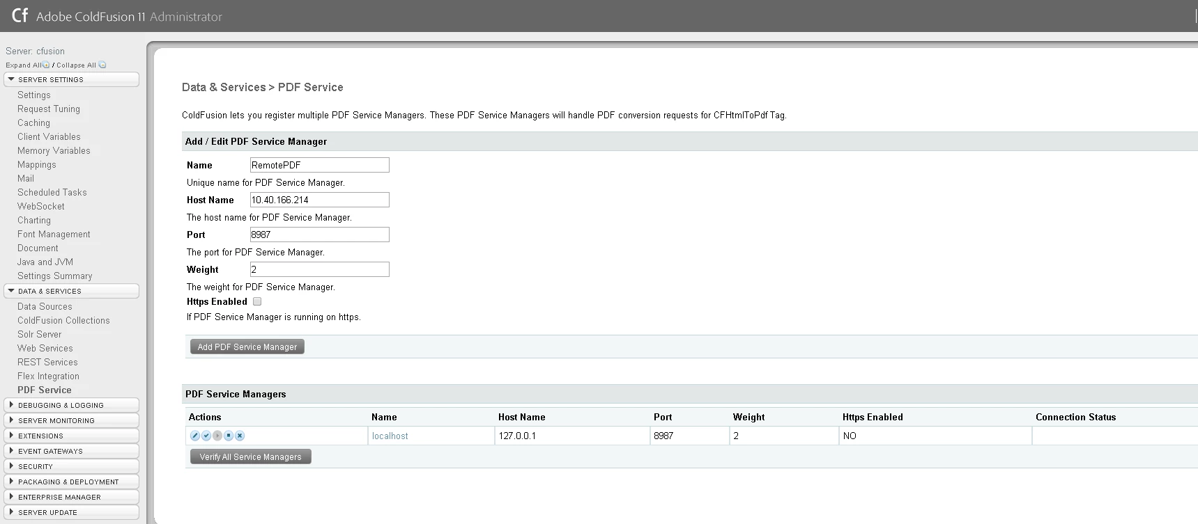

    3. Launch the ColdFusion Admin where you wanted to add the Add service and use these details.
    4. Once you add the service, start it using the start button.

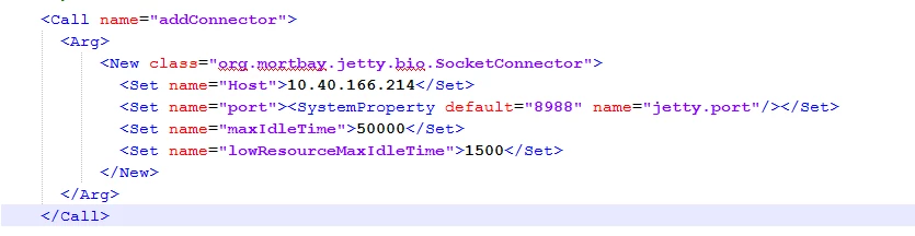

    In case you're not sure about the port please go to this location where you have installed the Add on service "C:\ColdFusionAdd-onServices\etc\" and open the "jetty.xml" look for this.

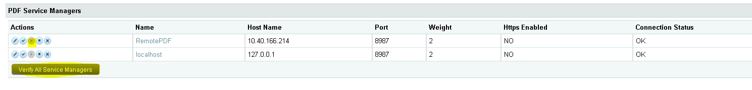

    After following all the steps it looks like this.
    Hope this helps.
    Priyank
