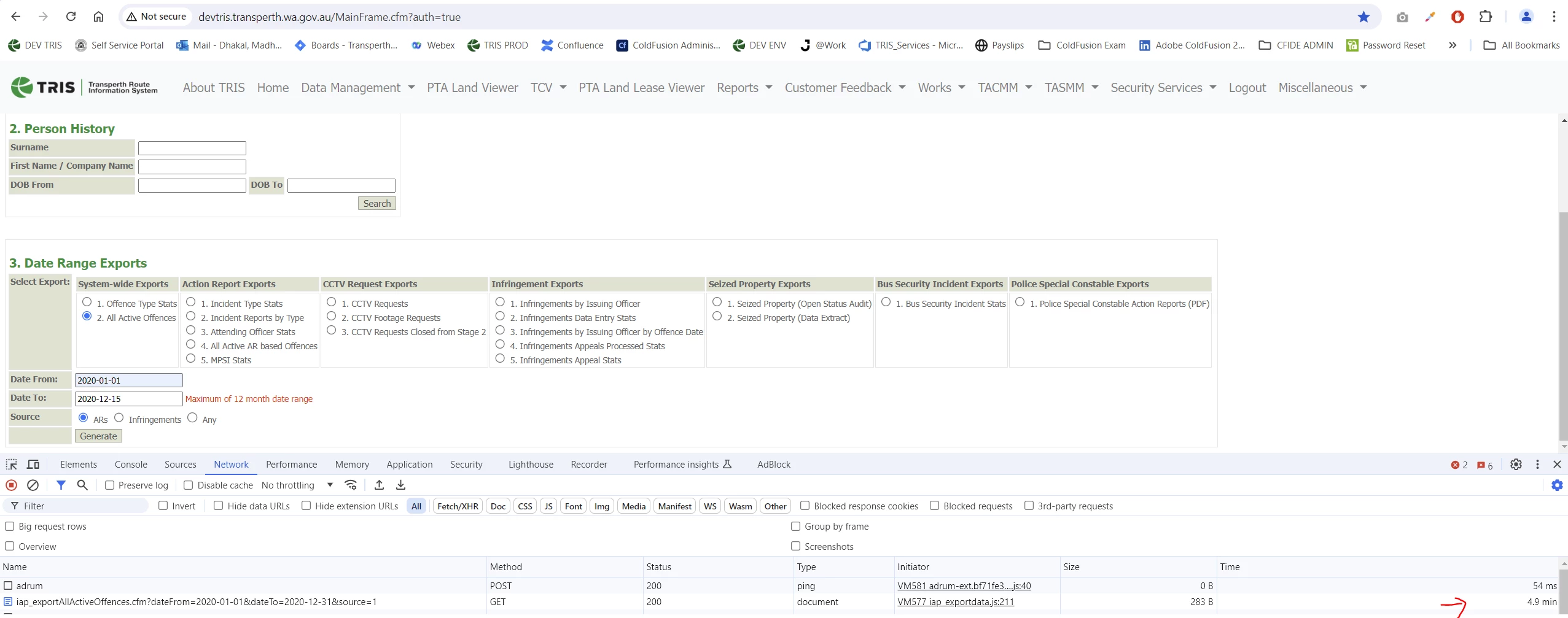

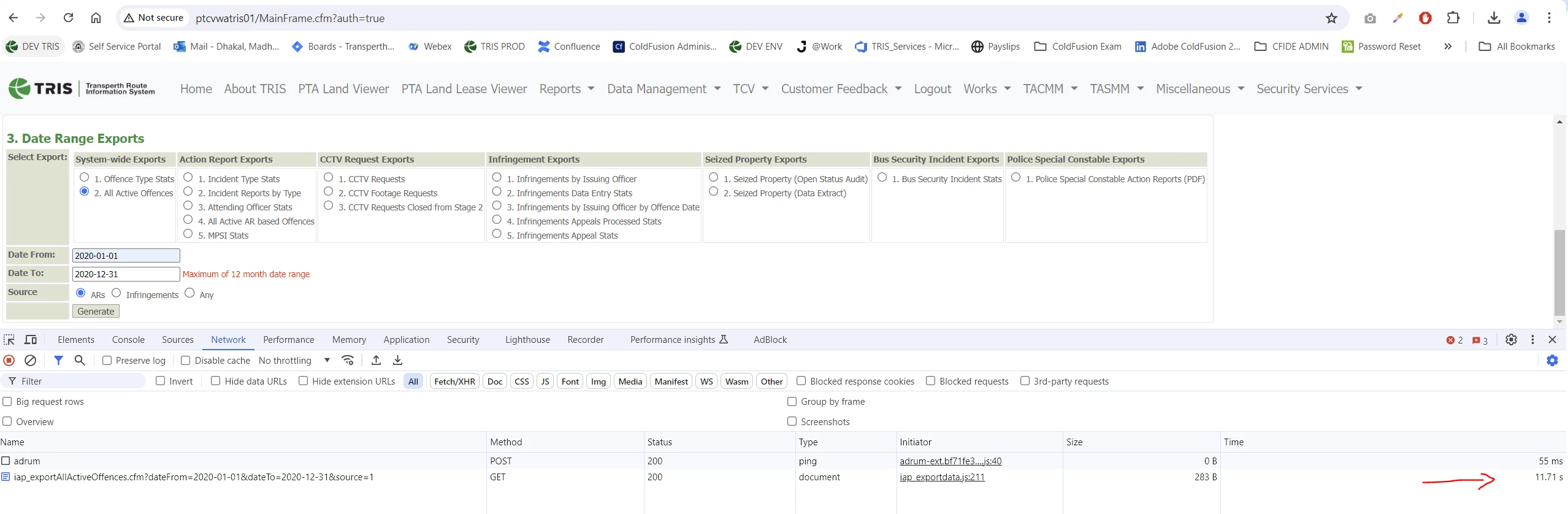

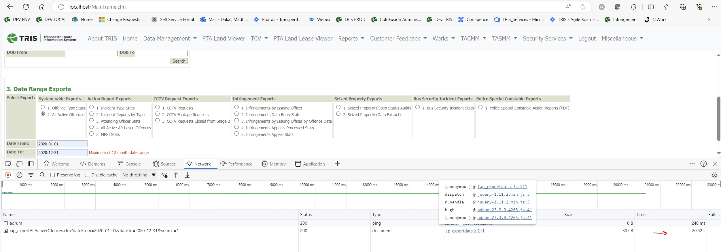

I'm facing significant performance issues after upgrading from ColdFusion 2018 to ColdFusion 2023. It's not really a migration, as I have both servers running CF 2018 and CF 2023. I recently created CF 2023 from scratch. Specifically, I'm facing much longer processing times for a task involving CSV exports. Interestingly, the same CF 2023 setup works well on my local computer (developer setup on Windows 10) but takes too much time on the CF 2023 Enterprise server.
  • CF 2023 (Local): the export takes 20.42 seconds.
  • CF 2018 (DEV 01): the export takes 11.71 seconds.
  • CF 2023 (DEV 02): The same export takes 4.9 minutes.

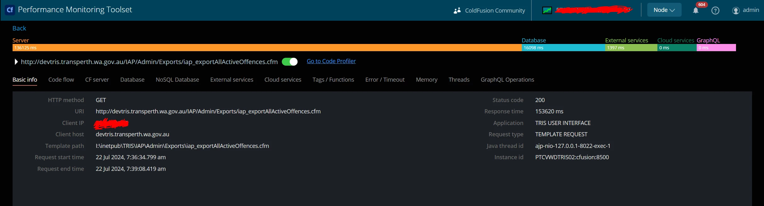

    Regarding monitoring tools, I am currently using CF PMT but haven't found any leads on the performance issue so far. Given this, I will consider your recommendation to try FusionReactor for a more in-depth analysis. Please find the image attached.

    Indeed, you shared a LOT of code in another reply here, including code that reads AND writes files, as well as call cfc's, and much more. As bkbk said, you may be able to put code in place around potentially slow code, but where to start?
    Instead, since you are using the PMT already, you should just take advantage of that. And I see that you have the profile feature enabled. Look at the tag/functions tab on that request, which will tell you where the most time was spent. See also the other tabs, in case that may tell you/us more.
    That said, trying to observe, interpret, and make recommendations here based on that can be challenging. Sometimes one answer will lead to a new question. Again, I can help far more effectively in a session together. Or maybe Adobe will step to offer that for free.
    Otherwise, if the profile info or the results of bkbk's code doesn't help you readily solve things in your own, you can share the info here and we can all engage in back and forth to try to get to the bottom of your issue. There will be an explanation.
