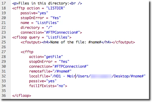

Hello community, I am having some issues when trying to get some files from an FTP site.
This is the situation:
I need to be able to connect to the FTP, list the files (all XML), read them and then save their contents into a DB table.
So far I can connect, I can read the files. This part is ok when I test in my own FTP/Coldfusion server.
However, the real scenario is different: files are in a different server server. So From my server I CFFTP to this server, I list the files and it works great.
But in order to read the XML files I need to get them first to my local machine and from it to upload it to my server where I have ColdFusion. Once there I can do whatever I want.
But I can't get the files.
So this is what I do:
1. I open the connection.
2. I list its contents and while I loop, I do the getFile:
So I have no error and the files are listed on screen, but no file is saved on my Desktop:
Any idea what could I be doing wrong?
Thank you!

    Where is the "/HD1 - Main/Users" folder, on your local machine or the machine running ColdFusion? The LOCALFILE must specify a location local to the machine running your ColdFusion server.

    Dani Szwarc
    Jul 18, 2019 9:50 PM UTC
    John, that did the trick! Thank you very much!
    All the examples I see online for the "GetFile" talk about local directory. When I read "local" I understood was actually my computer.
    I really appreciate your help!
