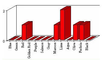

I have been doing all my development under CFMX (CF6) for years because I was on the development team for it at Allaire/Macromedia. My website however is deployed on a CF8 platform. I have some software that generates graphs based on survey results on the fly (bar, pie, line based on user preference/button pushing). I use "itemLabelOrientation = vertical" and under my CF6 development env it generates a chart that uses vertical words (only if it has to, such as the chart on the left) and horizontal words when not needed. It automaticaly makes this decision when I use the "itemLabelOrientation = vertical" attribute.

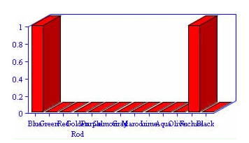

HOWEVER... under CF8 it does not honor the attribute and produces this;

    Correct answer Adam Cameron.
    Dunno what docs you read.  But these are the official ones:
    CFCHART
    http://livedocs.adobe.com/coldfusion/8/htmldocs/Tags_c_05.html
    CFCHARTSERIES
    http://livedocs.adobe.com/coldfusion/8/htmldocs/Tags_c_07.html#2741830
    (this is where you set the chart type)
    CFCHARTDATA
    http://livedocs.adobe.com/coldfusion/8/htmldocs/Tags_c_06.html#2748541
    Creating Charts & Graphs
    http://livedocs.adobe.com/coldfusion/8/htmldocs/graphing_01.html#1156498
    Those cover everything you need.
    CFGRAPH has been deprecated (note: "depreciated" is a different word meaning a different thing, btw) since CFMX6.1, as far as I know.  CFGRAPH was a half-arsed implementation which was pretty much discontinued immediately.
    Pls tell me you are not running CFMX6.0.  Please tell me you're using at least using 6.1.  6.0 was a kinda like an alpha for 6.1.  It's not appropriate to use it in production.
    Adam
    March 10, 2011
    Take a look at the CFCHART documentation. CFCHART and related tags have replaced CFGRAPH.
