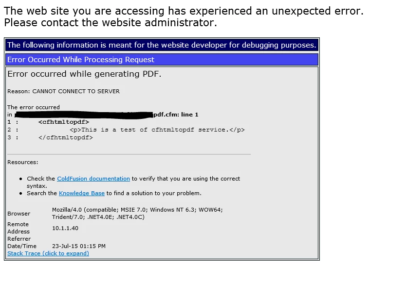

I've run into a similar problem, but the error I get is "CANNOT CONNECT TO SERVER". The remote service request logs show a 400 error (bad request) but I'm not sure what is wrong. Have you made any progress with this issue?

Can you post a screenshot of the issue?

PDFG service request log:
10.1.1.42 -  -  [23/Jul/2015:17:15:11 +0000] "POST /PDFgServlet/ HTTP/1.1" 500 319
10.1.1.42 -  -  [23/Jul/2015:17:15:16 +0000] "POST /PDFgServlet/ HTTP/1.1" 200 -
10.1.1.42 -  -  [23/Jul/2015:17:15:16 +0000] "POST /PDFgServlet/ HTTP/1.1" 400 331
10.1.1.42 -  -  [23/Jul/2015:17:15:38 +0000] "POST /PDFgServlet/ HTTP/1.1" 400 331
I've tried enabling logging in the PDFgServlet\WEB-INF\web.xml file but that just causes the remote service to crash.
