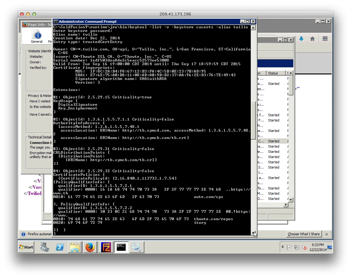

So I went and imported the the certificate into the cacert keystore. Here it is listed:

    Make sure you put the cert into the correct certificate store. We use the latest Oracle JRE that CF9 supports and it has it's own cacerts library. The other issue I have seen is make sure the damin name in the cert matches the domain name you are using in the cfhttp call. Lastly, check the contents of the coldfusion http log. Sometimes it contains the missing piece of data you need to diagnose the real issue.

    The cert is a wildcard *.twilio.com so that my be the issue. I used the CF keytool to import the cert so I assume it is in the correct store. How do I check that?

    Correct store: In the CF administrator pull up the server info. Somewhere on that page will be the Java Home and that will be the root to where the cacerts store is located.
