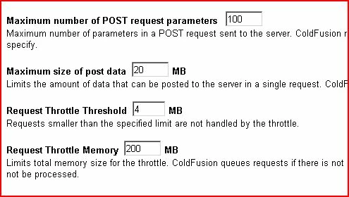

Check how many post parameters are being sent along, if it is more than 100 then that could be the problem. If so play with the "Maximum number of POST request parameters" in the ColdFusion Administrators (CF10), if it is in CF9 then that setting setting must be done manually in the neo-runtime.xml file see: http://www.cutterscrossing.com/index.cfm/2012/3/27/ColdFusion-Security-Hotfix-and-Big-Forms
Maximum number of parameters in a POST request sent to the server. ColdFusion rejects requests if the POST parameters exceed the limit you specif
January 3, 2013
Don't seem to be a POST settings problem. I tried upping the max to 1000 and still failed. But it's typically only a couple of parameters with each request.
