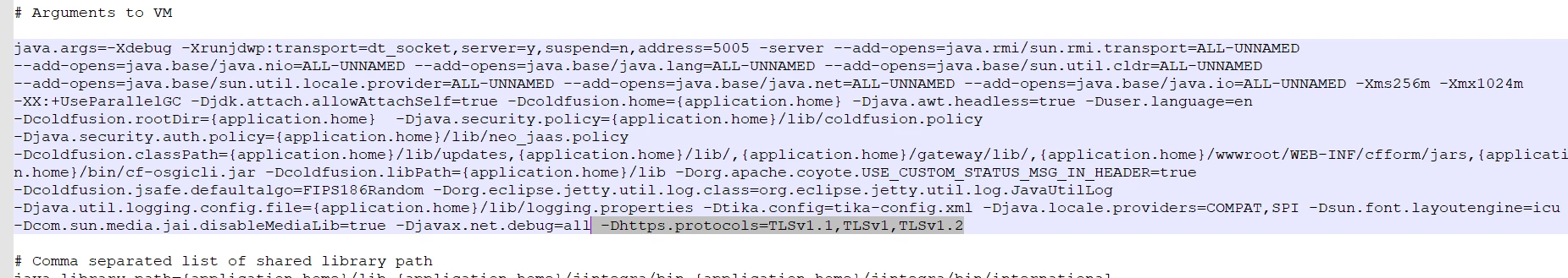

    I tried this and ran into the same issue, I added the SSL debugging and found there is an issue with TLS version. Can you add this in the jvm.config and restart CF and try again. Added the screenshot of my jvm arguments. After this the code worked.
    -Dhttps.protocols=TLSv1.1,TLSv1,TLSv1.2
    Thanks, Priyank Shrivastava
    Sep 27, 2021 11:26 AM UTC
    Hi Priyank,
    days of searching and getting crazy are over, thanks a lot for your help!
