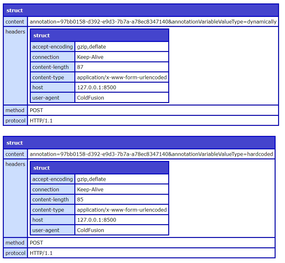

    May 24, 2022 12:08 PM UTC
    Yes, that's strange. Does the variable contain by chance an extra pair of quotes? When I did the following test, I couldn't reproduce the problem.
    I placed test1.cfm and test2.cfm in the webroot, launched test1.cfm in the browser, and then examined the HTML file in the logs folder.
    test1.cfm
    <!--- Dynamically --->
    <cfset annotation="97bb0158-d392-e9d3-7b7a-a78ec8347140">
    <cfhttp url="http://127.0.0.1:8500/test2.cfm" method="post">
    	<cfhttpparam type="formfield" name="annotation" value="#annotation#" encoded="false" >
    	<cfhttpparam type="formfield" name="annotationVariableValueType" value="dynamically" >
    </cfhttp>
    <!--- Hard-coded --->
    	<cfhttpparam type="formfield" name="annotation" value="97bb0158-d392-e9d3-7b7a-a78ec8347140" encoded="false" >
    	<cfhttpparam type="formfield" name="annotationVariableValueType" value="hardcoded" >
    </cfhttp>
    done
    test2.cfm
    <cfscript>
    	writedump(var=GetHttpRequestData(), format="html", output="#server.coldfusion.rootdir#\logs\HttpRequestData.html");
    </cfscript>
    Result:
