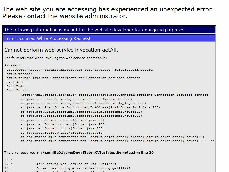

When you run this test page from the browser we get:
But if you enter the url to the web service(https://notworking.server.net/webservices/link/mhe/MHESqlData.cfc?wsdl) directly into the browser it works. Even if you append the url with the same method called in the invocation (https://notworking.server.net/webservices/link/mhe/MHESqlData.cfc?wsdl&method=getall) it returns data like expected.
But in the code we get the message shown above: Connection refused: connect
There is no firewall between the servers. The security certificate from the "not working server" was imported into the cacert file for the server calling the service and we have verified that it is not expired.
The programmer has moved ahead with his project, changing calling this file with <cfhttp> instead of <cfinvoke> and his data is returned. He does not want to stay with that method.
Any ideas of ways to troubleshoot/fix this ???? My friend google is not very helpful with this error.
