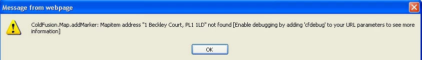

Im using CFMAP looping a query of address from a DB, the output is  street address and a postcode, if the user enters the postcode wrong CFMAP thoughts a JavaScript error to screen saying debug needs to be enabled.  is there a way to debug to catch errors then not process them to the map, i.e. if it cannot find just ignore. Im out putting around 80 map items
Thanks
Jeremy

Thanks but it doesnt do anything, Im not sure its a coldfusion error more of a google api error? i attach an image of the error.
code looks something like (within a cfmap tag):
<cfoutput query=
"GetProperty">
<cfsavecontent variable=
"showtext">
<img src="uploads/#MainIamge#-1-m.jpg" width="150" height="120" alt="" border="0" /><br />
<strong>#PName#</strong><br />
#Rooms# rooms<br />
Plymouth, #PostCode#<br />
<br />
<a href="Details.cfm?id=#PropertyID#">view details</a>
</cfsavecontent>
<cfmapitem name=
"#PName#"
address=
"#PName#, #PostCode#"
markerwindowContent=
"#showtext#"
tip=
"#PName#"/>
</cfoutput>
