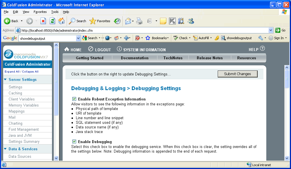

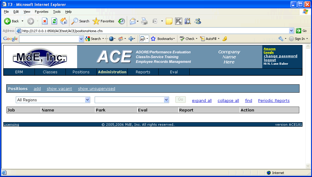

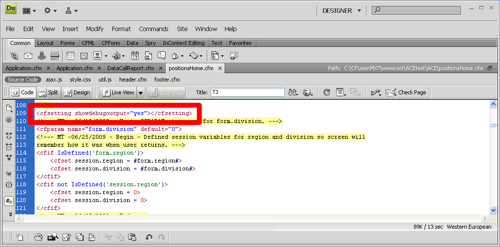

    Thanks for the suggestion. But that did not solve the problem. Please see attachments. Attachment 1 shows the debug settings in the CF administrator. Attachment 2 shows that debug is set to yes in the CFM. Attachment 3 shows there is no debug output.

    I think the debug output setting is a flag so the last ]]> setting wins. Can you search and make sure that you
    don't have any other showdebugoutput settings in your file ?
    Also, what does the isDebugMode function return at the end of you file
    ? (you can try cfabort at the end of the file to make sure that no
    other code is executed that might change the value of the
    showdebugoutput flag ).
