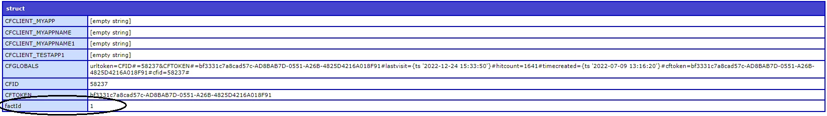

    I do not expect that code to produce an error. In fact, when I run the following test code
    <cfparam name="cookie.factId" type="any" default="1">
    <cfdump var="#cookie#">
    the result is
    I am on ColdFusion 2021 Update 5.
