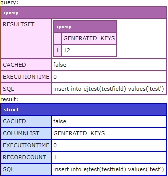

We have been using the result structure from CFQUERY for years to retrieve an inserted ID, but it started to fail after applying update 2021/11 recently. It would appear that we now need to pull the inserted ID out of another structure entirely. I created a simple test scenario below and dumped out both the query and result structures - note that GENERATEDKEY is no longer in the result structure:
<cfquery name="myquery" datasource="#ds#" result="myresult">
    insert into ejtest(testfield) values('test')
</cfquery>
The test table has both an identity field and PK set on that field. It produces the same result whether I have a PK set or not, however.

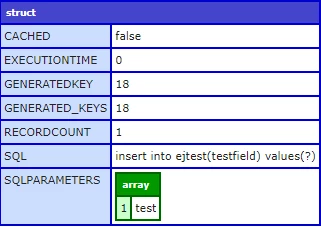

I think I see what's going on here now - if I parameterize the input (which we should be doing anyway), the generatedkey attribute is returned:
<cfquery name="myquery" datasource="#request.cfg_db_to_use#" result="insert_org_result">
    insert into ejtest(testfield) values(<cfqueryparam cfsqltype="cf_sql_varchar" value="test">)
</cfquery>
It is strange that update 11 created this anamoly, though.

Strange indeed. The result structure in the second test misses a 'columnList' key. I wonder what would happen if you ran the following code in both tests:
<cfoutput>
resultStruct.columnList:#resultStruct.columnList#<br>
resultStruct.generated_key:#resultStruct.generated_key#<br>
resultStruct.generated_keys:#resultStruct.generated_keys#<br>
</cfoutput>
