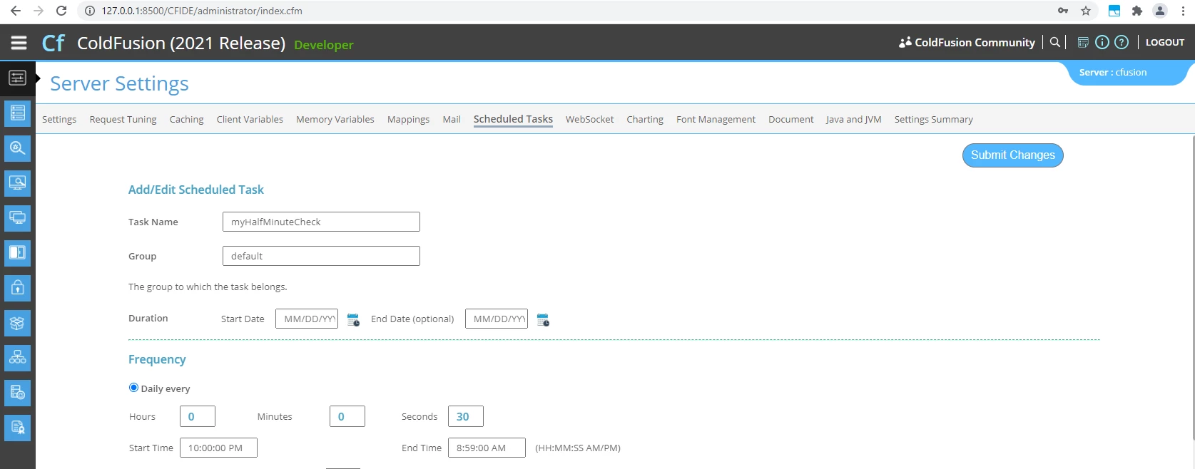

Silly question that I can't quite figure out:
I want to schedule a task via the CFAdmin panel to run a .cfm script every 30 seconds starting at 10pm and ending a 8:59am the following morning.
Right now, I am unable to figure out how to do this as one task.  Instead, I've had to set up a "daily" task that runs every 30 seconds starting at 10pm (with no end  specified), and then a second task (that runs the same .cfm script) that starts at 12am and ends at 9am.
Is there a way to do this as a single task instead of the two?  It's not a huge deal, just trying to see if there an obvious way to do that my brain is not seeing at the moment.

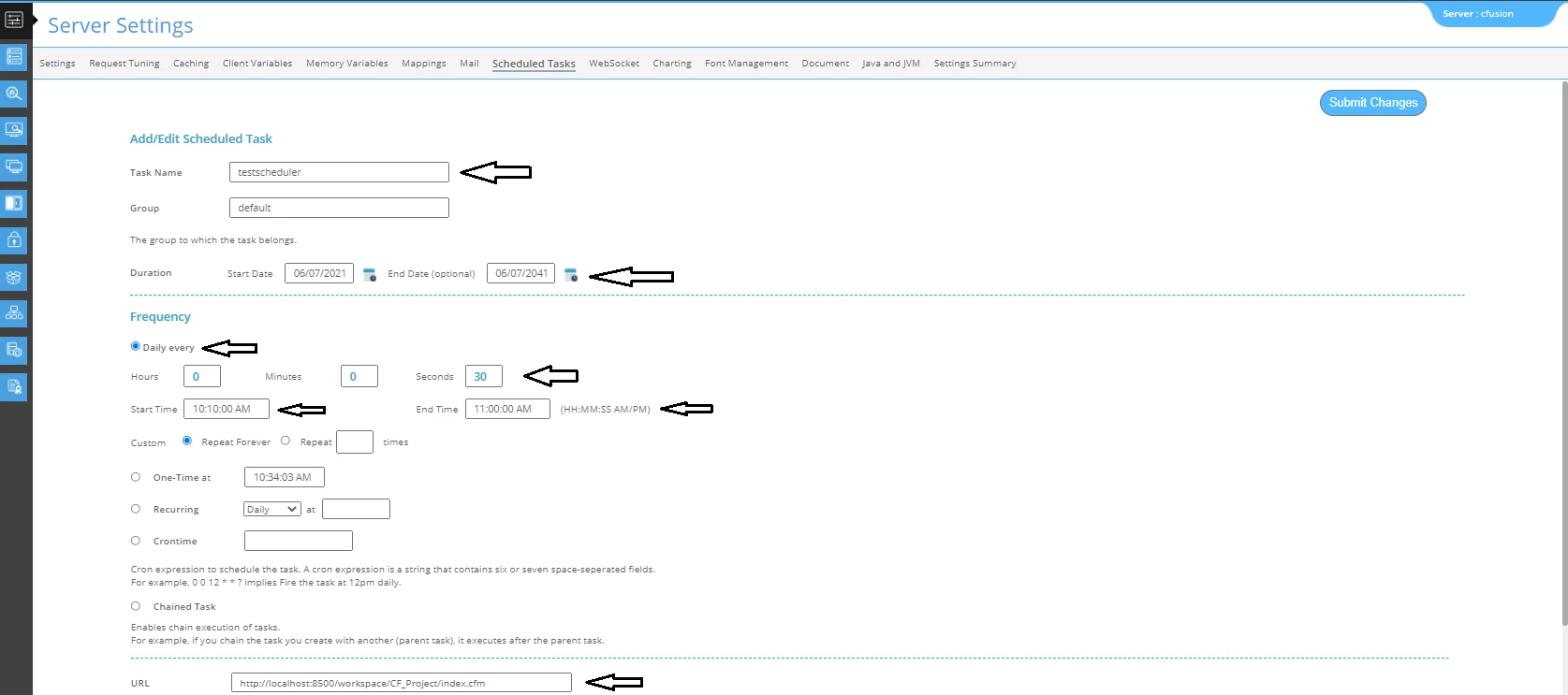

    BKBK
    Jun 7, 2021 8:29 AM UTC
    @Charlie Arehart , the suggestion I gave does in fact work. I took it for granted that TwoEdge will fill in the start-date and end-date.

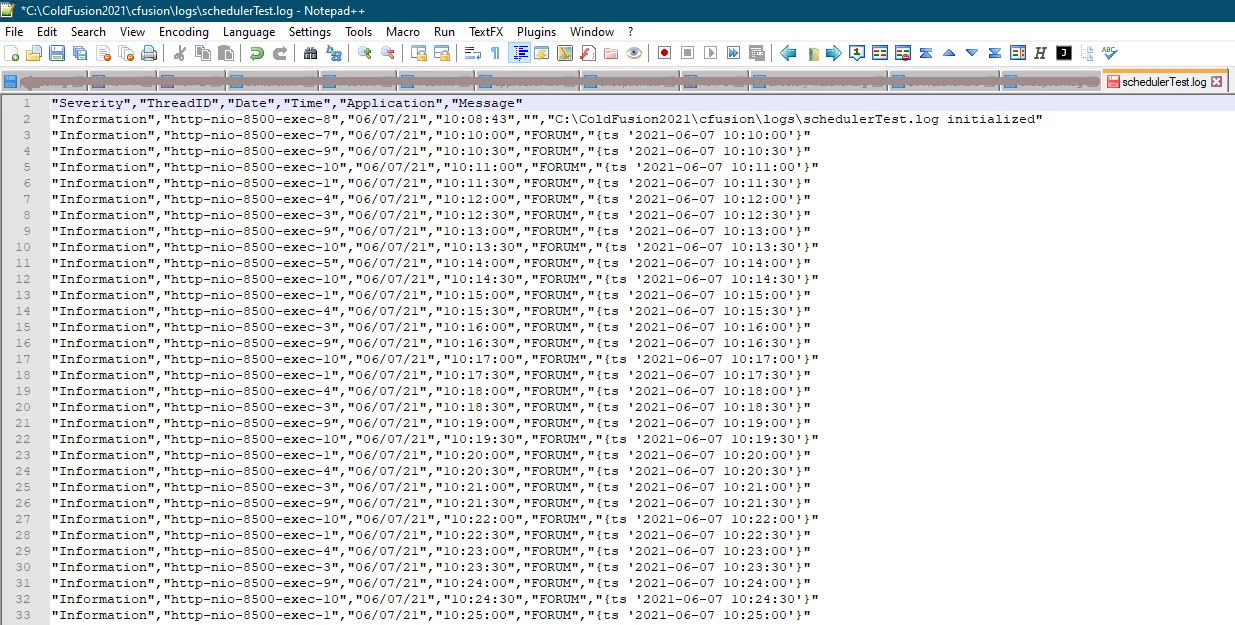

    @TwoEdge , the following settings are for a full, working example I created just now. It took me 6 minutes.
    The index.cfm page consists of one line of code:
    <cflog text="#now()#" file="schedulerTest" type="information">
    The result:
