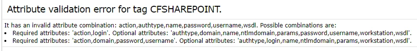

    I removed the attribute domain, then I got this error
     It seems I have to place domain in the code
    Thank you for your time

    Hi @pham_mn ,
    Is there perhaps a misunderstanding? Your code does need the domain details. I think what Priyank meant was for you to remove such private details from your post in this forum.
    As for suggestions, what happens when you do as ColdFusion says and just open the WSDL URL in a browser? That is a good test.
