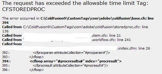

Has anyone ever come across the error seen in the attached screenshot?
The error is happening inside base.cfc. The error only happens sometimes, usually it takes a really long time to load but then sometimes it works fine.
Here is the code that is in item.cfc:
11     <cfscript>
12
13          local.spService = Application.db.sp("spGetItem"); // Custom code to create a stored procedure
14          local.spService.addParam(cfsqltype="cf_sql_integer", value=arguments.ID);
15          local.spService.addParam(cfsqltype="cf_sql_integer", value=arguments.ContactID);
16
17          local.spService.addProcResult(name="qResult1",resultSet="1");
18          local.spService.addProcResult(name="qResult2",resultSet="2");
19          local.spService.addProcResult(name="qResult3",resultSet="3");
20          local.spService.addProcResult(name="qResul4",resultSet="4");
21          local.result = local.spService.execute();
22          local.returnValue = local.result.GETPROCRESULTSETS();
23
24     </cfscript>
Any help would be appreciated.

I've never seen a cfquery/proc timeout that hasn't just been a basic lock on the database coming from somewhere else. What's your timeout set to in CFAdmin?
October 13, 2011
60 Seconds.
