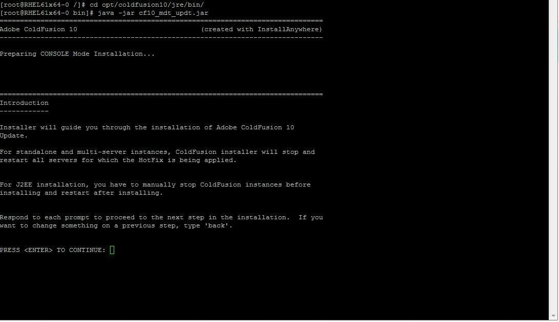

    vishu_13
    Jun 16, 2014 7:46 PM UTC
    I placed the cf10_mdt_updt.jar in opt/coldfusion10/jre/bin and then I type : java -jar cf10_mdt_updt.jar and press enter.
    I did the same in RHEL 6.1x64. The size of Mandatory update is 4.90 MB
    HTH
    Thanks
    VJ
