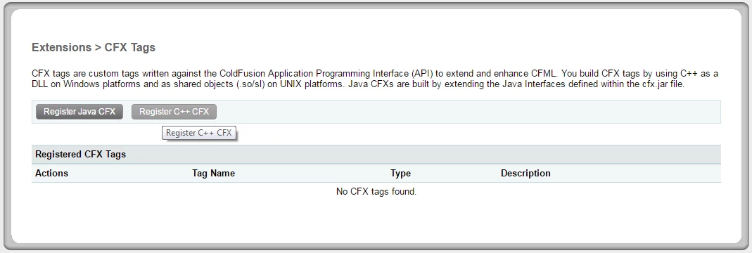

So make sure you define the custom tag paths for a ColdFusion instance in the Administrator of that instance. For example, below are the settings as defined in the Administrator of MyFirstCFInstance:

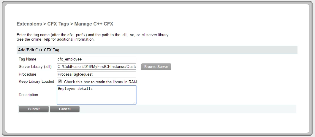

I clicked on Register C++ CFX. My input for the resulting interface was:

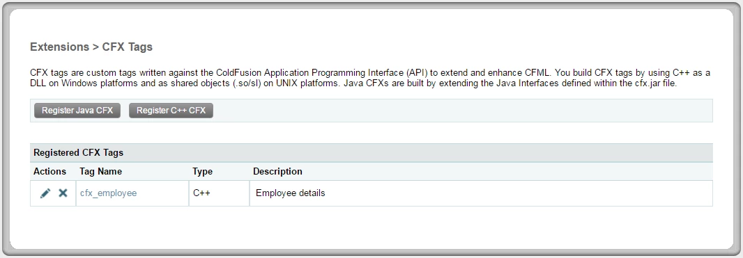

I had clicked on Browse Server to navigate to the location of the DLL. The path was C:/ColdFusion2016/MyFirstCFInstance/CustomTags/com/employee.dll. When I clicked on Submit, I got the following:
I then restarted the ColdFusion instance, MyFirstCFInstance.
