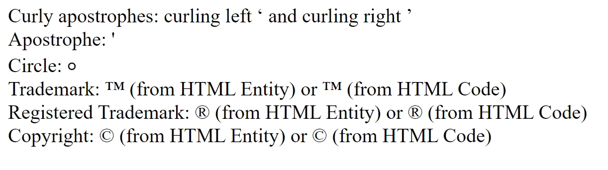

    I ran the following test using the values from the web site:
    <cfset testString = "Curly apostrophes: curling left &##8216; and curling right &##8217; <br>
    Apostrophe: &##39; <br>
    Circle: &##9900; <br>
    Trademark: &trade; (from HTML Entity) or &##8482; (from HTML Code)<br>
    Registered Trademark:  &reg; (from HTML Entity) or &##174; (from HTML Code) <br>
    Copyright: &copy; (from HTML Entity) or &##169; (from HTML Code)">
    <cfoutput>#testString#</cfoutput>
    The result was:
