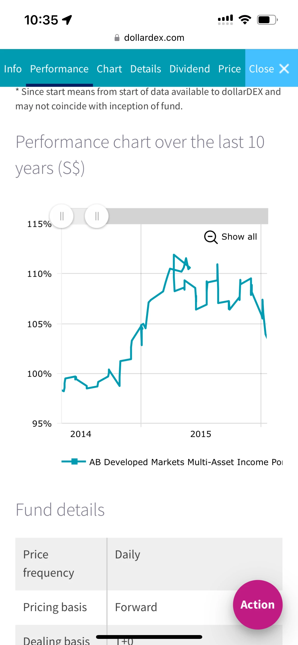

There are some glitches created/observed in graphs and graph is not displaying properly.
Please help/advise if anyone has faced similar issue before.

    Can you show us the code that produced this?  We're flying blind without more info from you.
    Hello Both,
    I am able to resolve this issue. CF2021 has made changes to dateformat function. Because of that dateformat(now(), "mm-DD-yyyy") was treating DD as day of the year. Hence, chart was unable to put the dots to connect at right places. After I added -Dcoldfusion.datemask.useDasdayofmonth = true in JVM arguments, date is passed in right format. Hence, graphs are getting plot right now.
    You can refer to change in dateformat function at https://helpx.adobe.com/sg/coldfusion/kb/dateformat-function-coldfusion-2021.html link.

    this is how graphs are impacted with glitches. Earlier it was very clear to read.
    March 6, 2024
