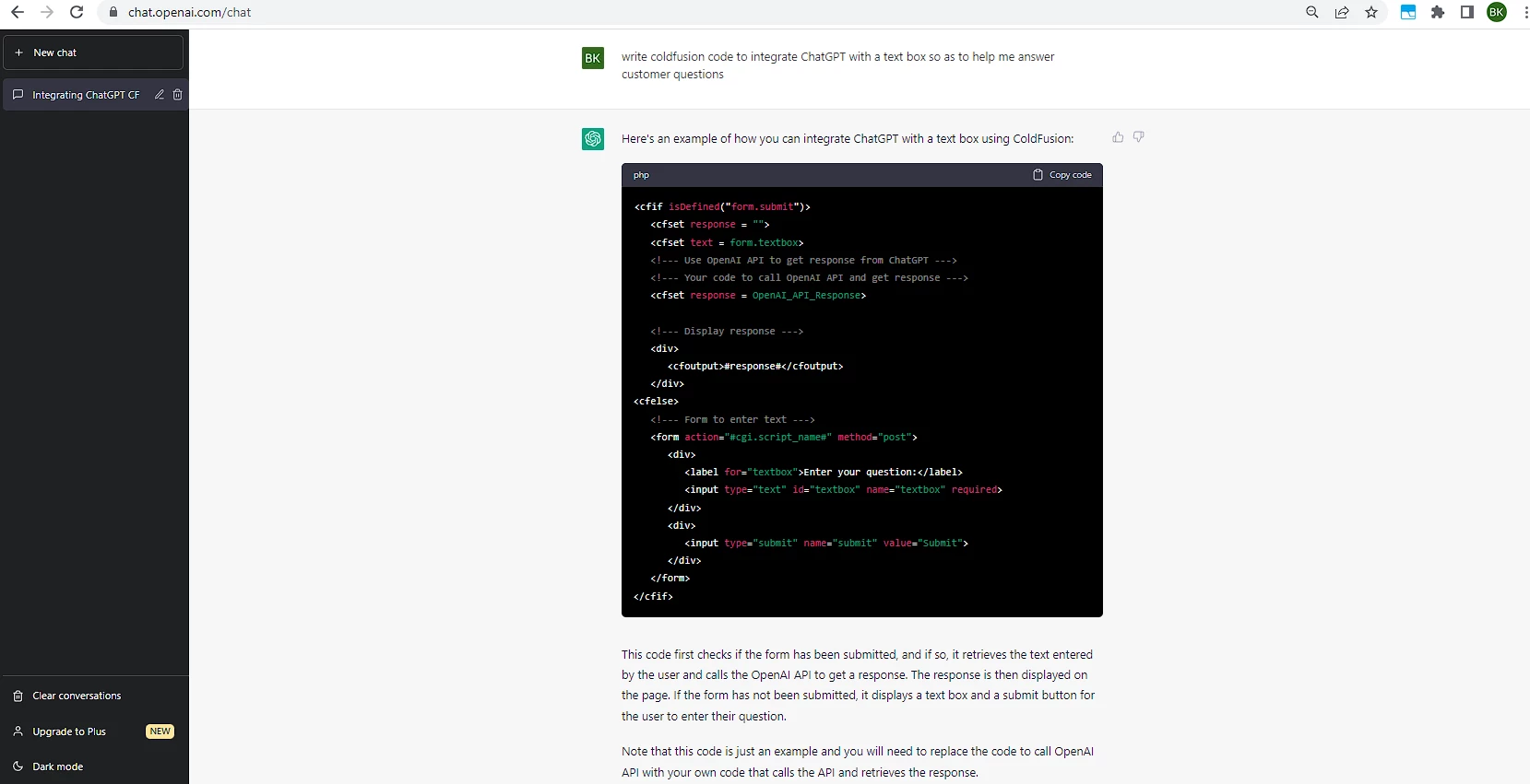

    Thanks for sharing that. When I used your prompt, ChatGPT duly provided the code. Correct, good ColdFusion code. Great example of what the combination ColdFusion + ChatGPT can do.
    Encouraged by this, I framed your original question as the following task for ChatGPT: "write coldfusion code to integrate ChatGPT with a text box so as to help me answer customer questions". The result is:
