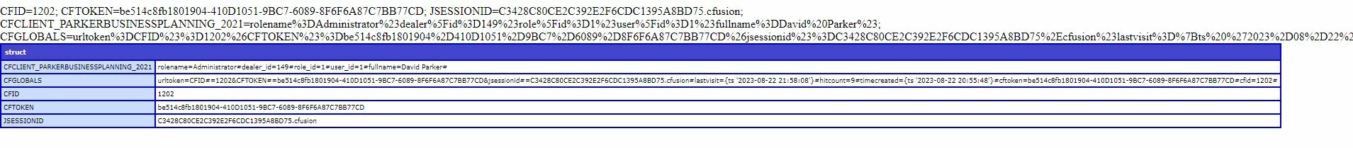

    Here is a dump of the cgi.http_cookie on the first line of app.cfc
    CFID=1202; CFTOKEN=be514c8fb1801904-410D1051-9BC7-6089-8F6F6A87C7BB77CD; JSESSIONID=C3428C80CE2C392E2F6CDC1395A8BD75.cfusion; CFCLIENT_PARKERBUSINESSPLANNING_2021=rolename%3DAdministrator%23dealer%5Fid%3D149%23role%5Fid%3D1%23user%5Fid%3D1%23fullname%3DDavid%20Parker%23; CFGLOBALS=urltoken%3DCFID%23%3D1202%26CFTOKEN%23%3Dbe514c8fb1801904%2D410D1051%2D9BC7%2D6089%2D8F6F6A87C7BB77CD%26jsessionid%23%3DC3428C80CE2C392E2F6CDC1395A8BD75%2Ecfusion%23lastvisit%3D%7Bts%20%272023%2D08%2D22%2021%3A58%3A08%27%7D%23hitcount%3D9%23timecreated%3D%7Bts%20%272023%2D08%2D22%2020%3A55%3A48%27%7D%23cftoken%3Dbe514c8fb1801904%2D410D1051%2D9BC7%2D6089%2D8F6F6A87C7BB77CD%23cfid%3D1202%23

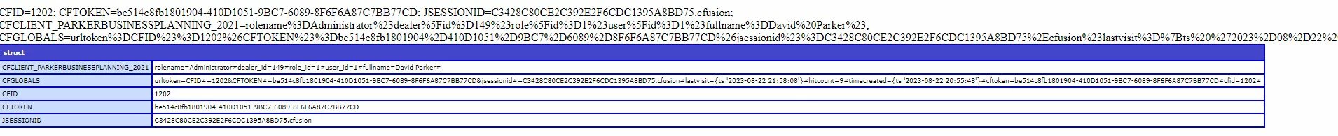

    and here is a dump of the cookie variable from the same place.
    This is a dump from within a file that is trying to find the client variable to make a determination on if it should show something or not.
    Like last time, here is the txt of cgi.http_cookie:
    And now the picture of http_cookie and the dump of cookie
    So dumping that cookie VAR out I can see the value that I am looking for. ITs role_id which its being compared.
    <cfif getDealersByTwentyGroup.recordCount gt 1 AND isdefined("client.role_id") AND client.role_id EQ 1>
    When this IF fails, nothing is sent to the screen since there is an AND there it doesn't see client.role_id but we do see
    its in the cookie scope.

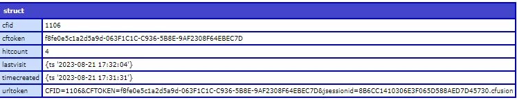

    Show a cfdump of the client scope in these cases. The one you showed originally is different. I'm simply saying show the values in conjunction with this dump of the cookies.
