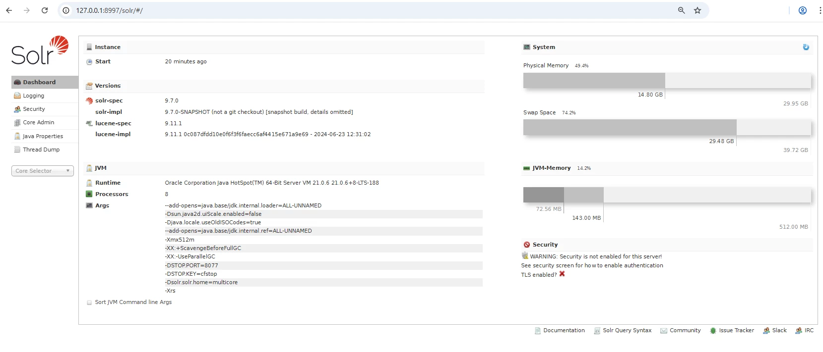

    5.  Open the URL http://127.0.0.1:8997/solr/ in a browser. The result is as expected:
    6.  Check ColdFusion's logs and jetty/logs/ and confirm there are no errors.

    2b) One is that I notice your screenshot of the solr dashboard, it shows one of the values as -Dsolr.solr.home=multicore. From my experience, that's the value one gets if you have implemented the separate add-on installer, in which case of course you need to be editing the jetty-ipaccess.xml within the etc subfolder where THAT was installed. By default, it would be /ColdFusion2025Add-onServices.
    Sadly, that solr dashboard does not confirm for us what folder the Solr is running in, beyond that jvm arg. (FWIW, with respect to the Jetty implemented within a CF2025 folder, the value would instead show -Dsolr.solr.home=C:\ColdFusion2025\cfusion\jetty\multicore
