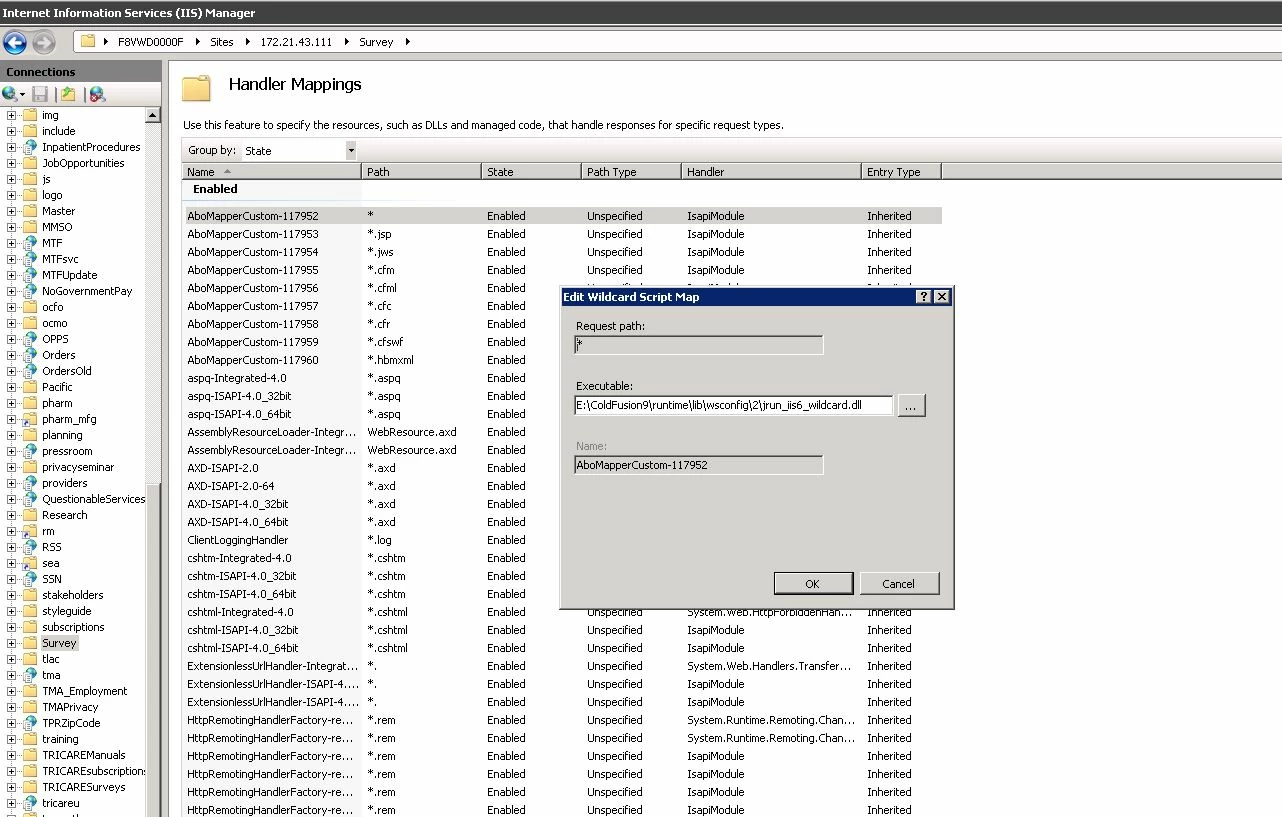

Cold Fusion Object Handlers in IIS
I have recently upgraded from ColdFusion 9 to ColdFusion 11. However in my websites in IIS the object handlers still point to ColdFusion 9. I during the installation of CF 11 used the wsconfig and there are no error messages in the log files. I can find no documentation on how to point the Object Handlers to Cold Fusion 11. Can anyone help?

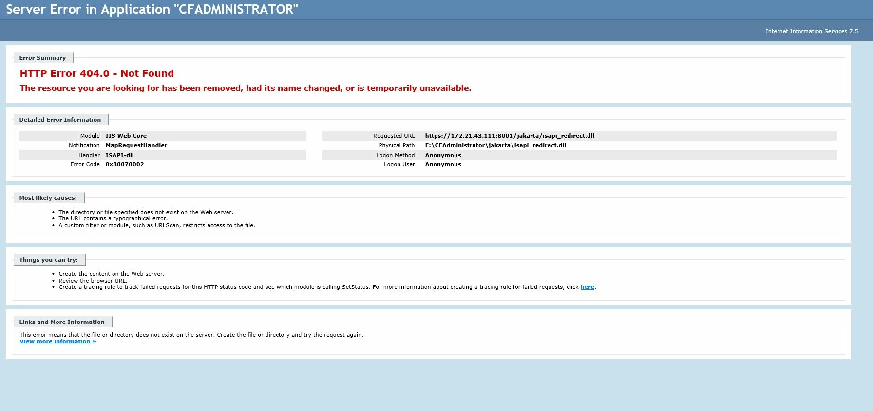

    I did as you advised and now on the CFAdmin site I am getting the following:
    Can you please check the ColdFusion Handlers, if they are missing under IIS.

    I have no browser error. The connector shows ColdFusion 9
    Priyank Shrivastava.
    May 15, 2017 3:14 PM UTC
    There are left over handler still exist on your website. You have to remove them manually.
    First, run the ColdFusion 11 wsconfig and remove the connector(location: \ColdFusion11\cfusion\runtime\bin).
    Second, run the ColdFusion 9 wsconfig tool and remove the connector(\ColdFusion9\runtime\bin or C:\JRun4\bin). After you remove the connector, you have to check the handler mapping and verify that there are no ColdFusion 9 handler exist.
    Then only run the ColdFusion 11 connector. Please check the blog which I mentioned, it as covered most of the places where you can see the connector left over entries.
