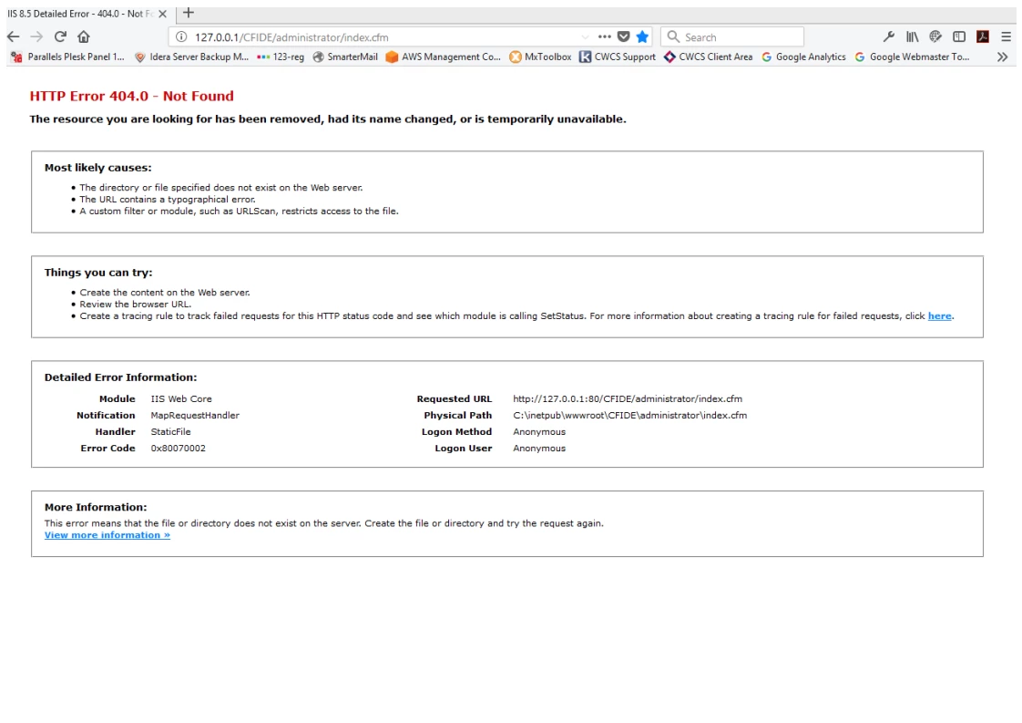

If I try typing in 127.0.0.1/CFIDE/administrator/index.cfm  I get a HTTP Error 404.0 Not found.

    I should explain what I meant by 'broken' Basically in our browser we had a bookmark for the cold fusion server which used to work until I did whatever I did, and now result in a error page (see attached screen grab)
    I have noticed that on the Physical path location, the folder CIFDE is missing on the computer.
