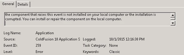

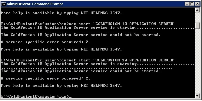

We have ColdFusion10 (update 17) Standard Edition installed on a Windows 2008 R2 server. It has been installed and running fine for a couple years, but in the last few weeks we have had trouble starting the service. After reboot it wouldn't start automatically or through a .bat file that checks to make sure it's started every morning. It also would time out starting from the Server Manager console. We were able to start it from the command line using net start "COLDFUSION 10 APPLICATION SERVER", but now it will not work that way either.
The logs do not appear to show anything unusual as far as I can tell. The only way we have been able to get it started is to run cfstart.bat in the cfusion\bin directory. The websites are available, but the actual service is not running (at least as far as windows monitoring is concerned).
This error is showing up in the server event log when we try to start the service:

    I’d say that there’s nothing in those logs to explain what’s happening.
    Are you finding that the ColdFusion.exe service IS or IS NOT running (in task manager) when you start it, after these log lines are written? If you wait several minutes? If it is NOT, then look in the coldfusion10\cfusion\bin folder (yes, the bin folder) to see if there are any logs there, starting with he_err_pid*.log. If there are, at the times of these startups, what do they say, in just the first few lines?
    If the ColdFusion.exe DOES remain running, but you just find you can’t find that it responds, that’s a separate problem.
    I will say that sometimes trying to debug these sort of problems in the forums is difficult. There are just too many variables. If there is a pressing need to get things working again, there are folks (myself included) who provide remote troubleshooting services (even if you can’t “let us remote in”). I list such consultants as a category of the CF411 resource on my site, specifically cf411.com/cfconsult.
