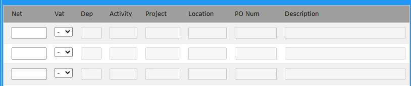

This is how the data is input-
The user should be able to input as many lines as nessecary, but should only have to populate Dep, Project etc on the first line, and it should be copied for all subsequent lines, only Net and VAT should be required for every line. This works as expected on CF11.
The CF21 page works for single lines but errors when more than one line is entered. The error code is as follows:
