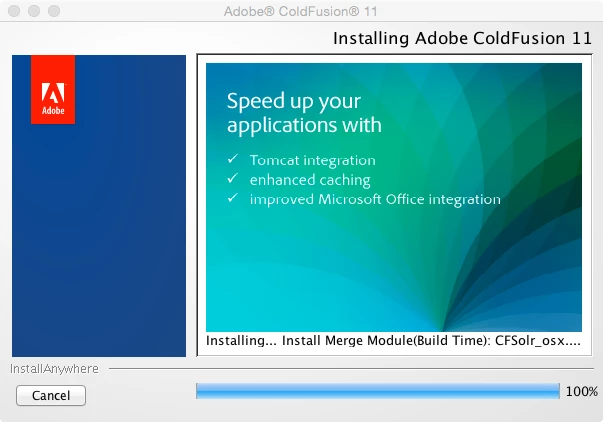

I'm trying to install ColdFusion 11 on a fresh install of OS X 10.10.1 with Apache. The installer gets to 100% with the message
Installing... Install Merge Module(Build Time): CFSolr_osx....

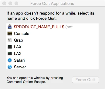

It then just sits there doing nothing. Looking at Force Quit I see the following
With the ColdFusion Installer showing the error at the top and the 2 java windows the installer opened called LAX.
I can see the installation log in the ColdFusion 11 directory and the last entry is this
Install Merge Module:     Z:\installers\CFSolr\installers\mergemodule\/CFSolr_osx.iam.zip
                          Status: SUCCESSFUL
                          Additional Notes: NOTE - Installing: SubInstaller1.zip
Not that I chose not to install the Solr components in the installer.
Any suggestions would be great as it's driving me mad.
Thanks

Right click on latest java window and quit that window.
The installation will continue and should complete successfully.
After installation, you will configure ColdFusion to start on System boot e.g.
  • computerName:~ user$ cd /Applications/ColdFusion11/cfusion/bin/
  • computerName:bin user$ sudo ./coldfusion start
Then start the server
  • computerName:bin user$ ./coldfusion start
