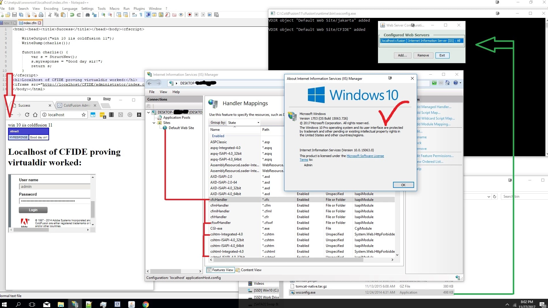

    Here's a screenshot for proof in case you had any additional doubts in my aptitude, eyesight, comprehension of dates, or reliability of resolution:
    See you on the next unresolved article!  Thank you for your super helpful response!
