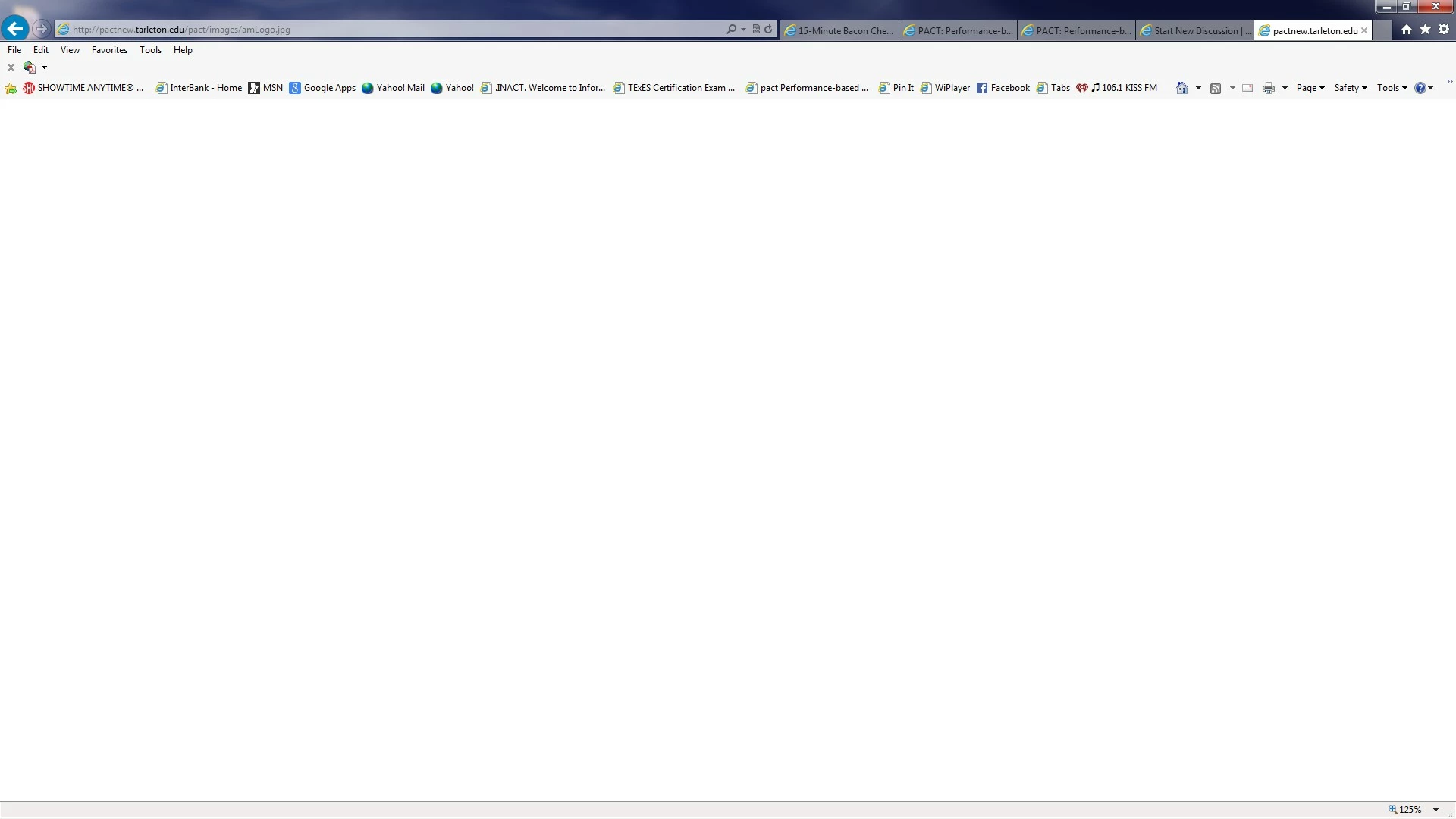

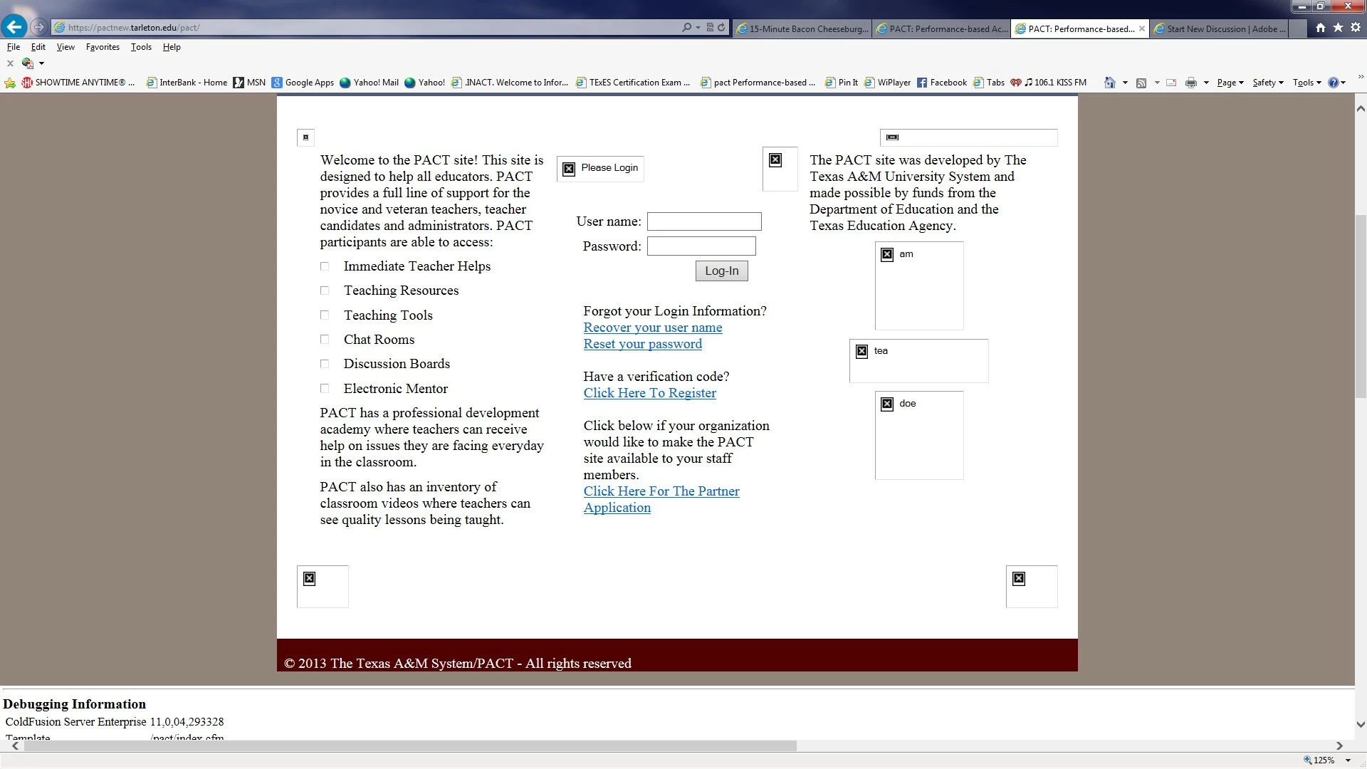

Here is what my page looks like now.
This is what the page looks like when I go directly to the image in the browser.
It is totally blank. Not even an X…
