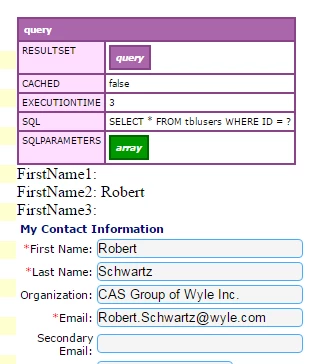

I am running a Coldfusion application for over 10 years and just upgraded to coldfusion 2016.  Now I am getting strange results.  I have a query that uses values from another query and it says the first query is not defined.  I can get it to work sometimes if I do a cfoutput first but not always.  Also, if I print a value from the first query multilple times, the first time in may be blank and the second time it returns the value.  If I do it 4 times, every other output is correct.  This only starting happening with the latest release.

    Below is the query and the output.  However, just running this query by itself will work.  It's when you have it as part of a larger file.  I have simular errors in other places that work it I put the <cfoutput></cfoutput> near the code that errors.  This fixes it sometimes but not all.  I should not have to do this.  The code worked great in Coldfusion11 and just stopped when I upgraded to Coldfusion12.
    <cfquery name="getHazUserInfo" datasource="#Application.DSN#">
    SELECT *
    FROM tblusers
    WHERE ID = <cfqueryparam value="#ID#" cfsqltype="CF_SQL_INTEGER">
    </cfquery>
      <cfdump var="#getHazUserInfo#" expand="no">
    <cfoutput>FirstName1: #getHazUserInfo.FirstName#</cfoutput><br/>
    <cfoutput>FirstName2: #getHazUserInfo.FirstName#</cfoutput><br/>
    <cfoutput>FirstName3: #getHazUserInfo.FirstName#</cfoutput><br/>
    Output
    Carl Von Stetten
