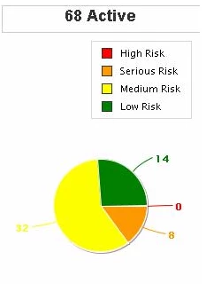

The pie chart below was created in ColdFusion v11
with the following javascript:
"graphset":[
  "border-width":1,
  "background-color":"transparent",
  "foreground-color":"black",
  "plot":{
  "value-box":{"color":"black"},
  "border-color":"black",
  "tooltip-text":"%t\n%v"
  "plotarea":{
  "margin":"dynamic"
  "legend":{
  "border-color":"red",
  "layout":"2x",
  "x":10,
  "y":30,
  "shadow":true,
  "height":"40px"
in v2016 the JS does not work at all and received an error:
SyntaxError: unterminated string literal (zingchart-rhino.min.js#8(eval)#1) The specific sequence of files included or processed is: C:\websites\HazTrak\html\HazPortal.cfm, line: 1
if I take out the javascript the pie chart looks like:
I either need a fixed so that v2016 will work with the same JS or an xml file to do the same as the js did.

    The problem turned out to be the \n was causing the error. Do not know why the \n (line feed) would cause an error. It should not and did not in prior version. Also noticed that the border is not displaying correctly. Using a width of "1" will only show up on the left side. In order to have the border show up around the entire frame, you need a width of "2", but then the left border is thicker. Again, this worked fine in the previous version. And finally the size of the pie will change size depending on the placement of the titles which did not happen in prior version.
