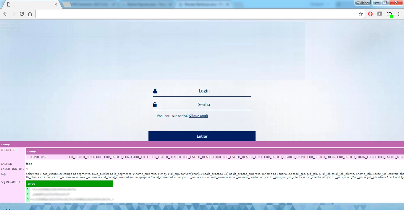

Jun 26, 2017 3:18 PM UTC
Expected result:
Issue:
Code:
Index.cfm
The session is set on this page that validates if the user is logged in or not:
<cfset session.qryCliente = new model.cliente().buscaCliente(dsn=this.dsn,id_job=url.job) />
If the user is not logged in it will be redirected to login.cfm after setting the session above
cliente.cfc

Login.cfm
If I dump the session with the query result, when the issue is impacting our servers the resultset comes with no records where normally should be one record.
<cfdump var="#session.qryCliente#" />
