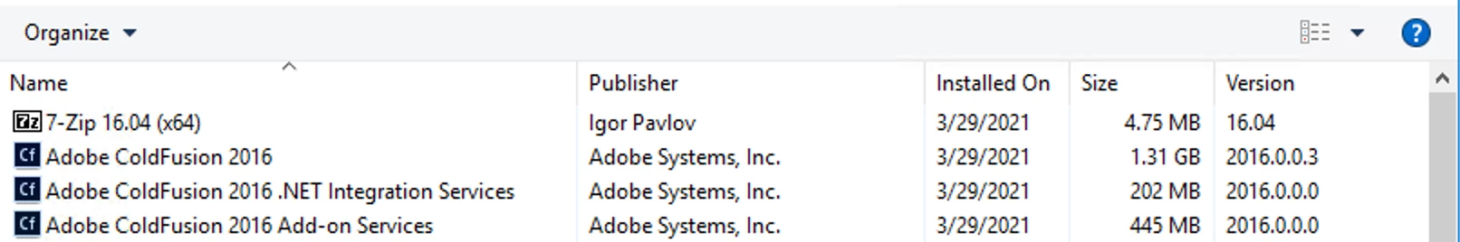

I am rebuilding our ColdFusion Webfarm and have the ColdFusion 2016 Windows X64 install media, and have identified the pre-requisites I need to build ColdFusion:
Microsoft Visual C++ 2009 32bit Redistributable: vcredist_x86.exe
Microsoft Visual C++ 2012 32bit Redistributable: vcredist_x86.exe
Microsoft Visual C++ 2012 64bit Redistributable: vcredist_x64.exe
.NET 4.5 64bit Development Suite: NDP46-KB3045560-Web.exe
I have the latest Hotfix jar.

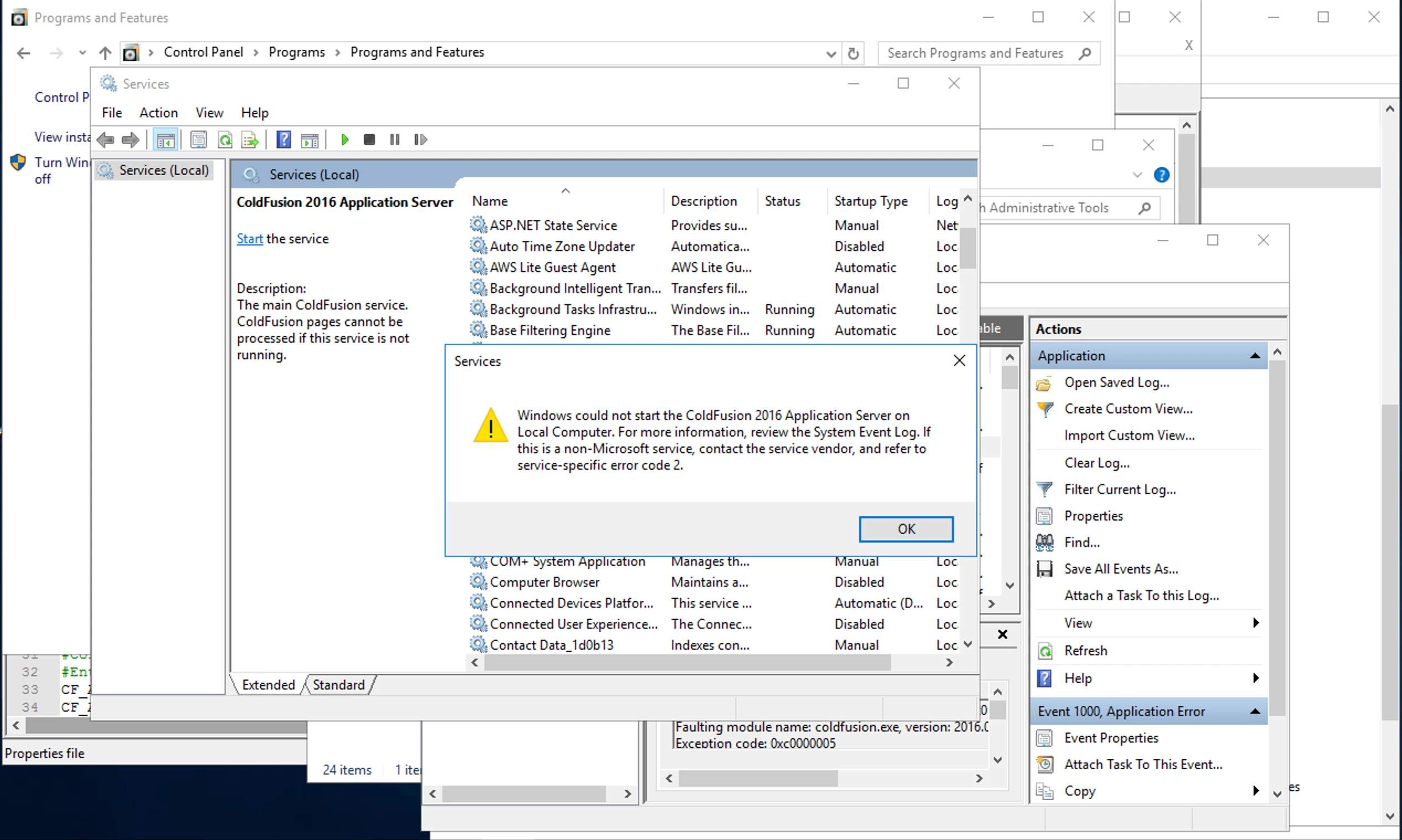

The silent install installs the above components but the coldfusion service can't be started as the installation is incomplete.

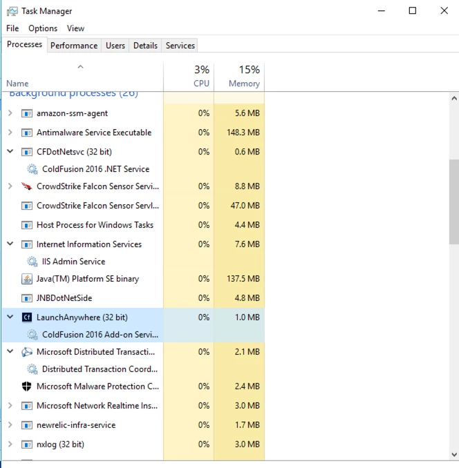

    The CF Service doesn't start.  CF is not running in Task Manager.

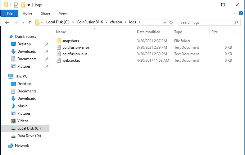

    C:\ColdFusion2016\cfusion\logs shows no log data, and no install log data which is somewhat worrying, see screenshot.

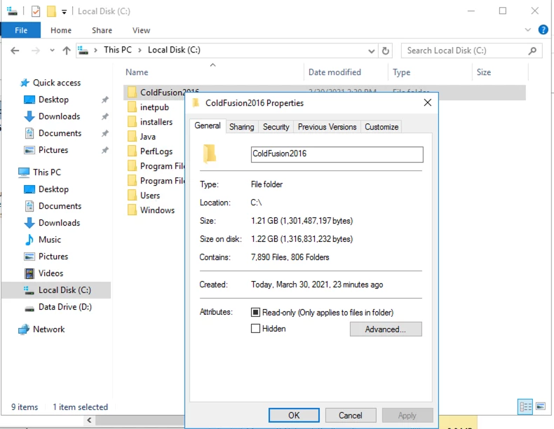

    The installer is hanging up at the same point regarding the contents of C:\ColdFusion2016, with 1.21Gb of data in the directory and 7890 files.  I am attempting to run ColdFusion as the Local Administrator account in the LocalSystem domain.

    And you show the "processes" tab, but I had proposed you look at the "details" tab. The latter has useful details (like the exact name of the process) that is lost in the simpler process tab view of things.
    For example, you say you ran the cfstart from the cmd line, but you don't clarify if you feel CF is running. You say only that you can't access the Admin. Again, I asked specifically that you go to the Details tab and sort it by name and see if a coldfusion.exe is running. Please confirm that.
    If it is not, then CF did not start...and the output of the cfstart should explain why. Or would you say there is no output from it on screen, at all?

    • Your screenshot shows the CF service not starting. Have you confirmed in Task Manager that CF is not already running perhaps? It could have been started as a process rather than as a service. Look in the "details" tab of Task Manager, and sort it by name. Is there a coldfusion.exe already running?
    • If it is NOT running as a task, go to the command line, and cd to the ColdFusion folder, then its cfusion/bin folder. Run cfstart.bat. That will start CF NOT as a service, and may well report information explaining what's amiss (though it may not be obvious what it means, or how the problems it reported came to be). What does doing that report?

    • If you look in the root of the CF folder, you will find an installation log for CF. In that, do you see it reporting "0 fatalerrors"? If you did, then something went amiss during the install.
    • If nothing did, but it fails to start now, then look in the CF cfusion/logs folder, and see if you may find "migration" or "car" logs, related to such an initial CF admin migration or use of the CAR migration.
