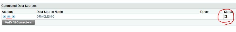

We have Coldfusion 2016 and it is running on Oracle 11g. we just updated from Oracle 11g to 19c and have tried to make a connection by creating a new data source with ojdbc8.jar in Data Source on a CF Admin.  The creation was sucessfully and the verfication also showed me "OK"

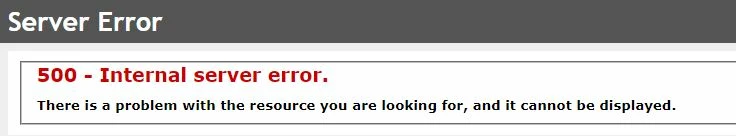

however, when running our web it showed an error below

1. downloaded a ojdbc8.jar ( I also tried ojdbc10.jar but no luck ) and placed it in C:\ColdFusion2016\cfusion\lib and then restated the service.
2. create a new data source in a DS page (I added the tnsoraname.ora below)
AAAA=
(description=
(address_list=
(address = (protocol = TCP)(host =xxxxxx)(port = 1521))
(connect_data =
(service_name=AAAA)
so, I put the JDBC URL and Driver class like that:
 JDBC URL:jdbc:Oracle:thin:@(DESCRIPTION=(ADDRESS_LIST=(ADDRESS=(PROTOCOL=TCP)(HOST=xxxxxxx)(PORT=1521)))(CONNECT_DATA=(SERVICE_NAME = AAAA)))
Driver Class: oracle.jdbc.driver.OracleDriver
the creation was successful and the verification also showed me "OK"
FYI: we have applied the update 11 so far.
I am still not getting a connection in our web. Can you tell me how to solve this problem? Your comments would be greatly appreciated.

    Yes. Look in the coldfusion-out.log when the error occurs. The 500 error may have nothing to do with the dsn setup (especially since that verifies ok).
    If there is nothing in that Cf log at the time, run the request in a browser on the server, IIS (which is showing the error) may show different details ON the server rather than off.
    There's much more that could be considered, depending on what you find. Let us know.
