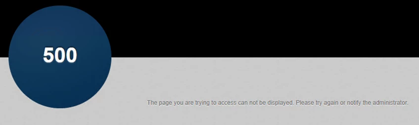

I've recently inherited a Coldfusion 2018 instance. I was provided a clone of the production server which I have running as a VM on an external drive. It's also up on AWS so that others on my team can access it remotely. I can access the CF adminitrator app just fine from the local VM at the typical address (http://localhost:8500/CFIDE/administrator/index.cfm). However, on the AWS VM (which is theoretically identical), I get the default CF 500 error screen at that same address. Not seeing any errors logged, so I'm not sure what is causing it. Has anyone else run into a similar issue? I'm at a loss for how to troubleshoot without any detailed errors.

    You say default 500 error. Can you be more specific, sharing the details? And have you confirmed the 8500 port is what cf is listening on? If you don't know how, tell us if it's a windows or Linux vm.

    Thanks for the follow up Charlie. By default 500 error screen I just mean it's showing the default template:
