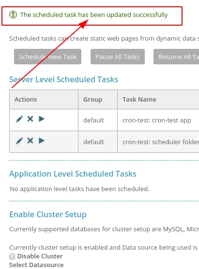

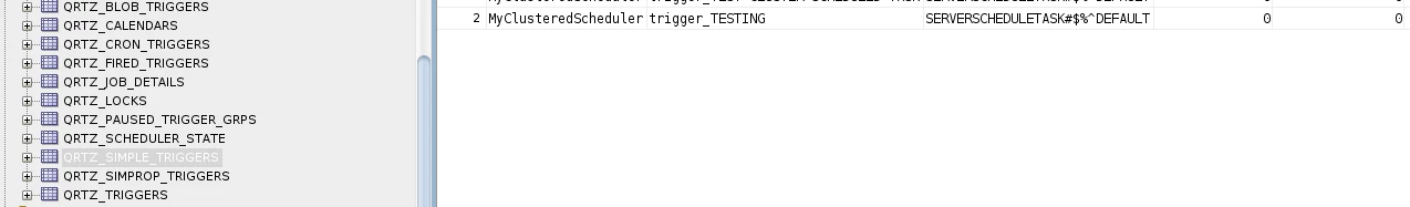

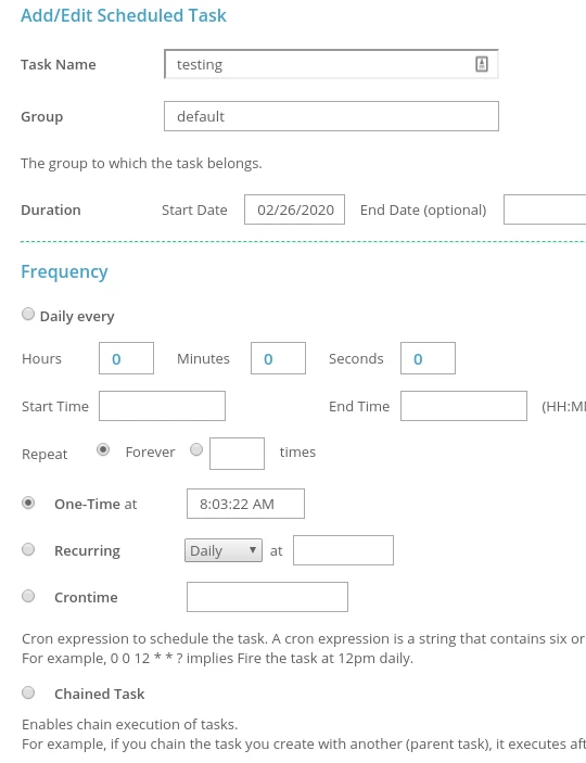

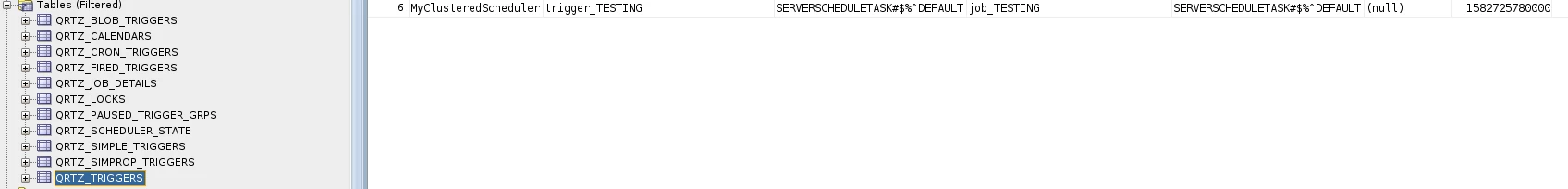

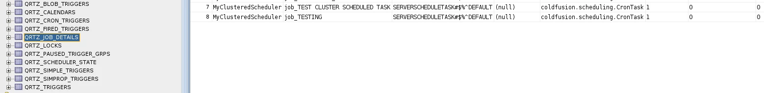

Yes, literally after creating clustered scheduled task in Admin console, after submitting the changes, it does not show up in the Admin. But I can see the cronjob I created in the cluster database. I can also see other server scheduled tasks that another admin created. I do have multiple instance, my default instance cfusion is turned off unless I'm upgrading.

I included few screenshots:

What happens if you create a task here and do NOT set it to be clustered. If that fails to appear also, then this is not about clustering at all, but again would seem to be about some issue with the neo-cron.xml that CF would be trying to write to, in this instance.
