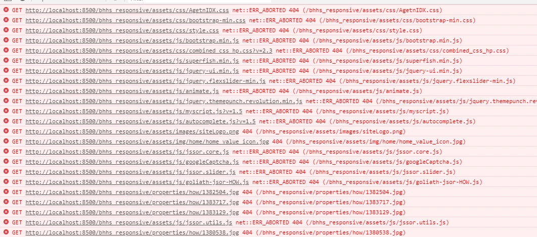

I just installed ColdFusion 2018 Developer Edition on my Windows 10 laptop and configured it to use the built-in web server. Previously I was using ColdFusion 10.
Now I have a case-sensitivity problem. For example, all css and js references are now case-sensitive, whereas they weren't when I was using ColdFusion 10. The same is true for calls to images and plain html files.
I modified the context.xml file (in the /cfusion/runtime/conf folder) to include <Context AllowLinking="true" caseSensitive="true"> (and yes, I also tried caseSensitive="false") and have restarted several times, but no luck yet.
The 404 error messages specify Apache Tomcat.
Any ideas on how to restore case-insensitivity? Thanks in advance for any help.

Dave - the CF developers previously provided a solution for this.  Pragati - I have the same issue and the previous resolutions did not resolve it - in fact, changing the context tag completely disabled my localhost.  The thing is - so many objects and files are affected because production environment does not look at the case.  Can we please add a resolution for this.  I think a major percentage of people have development environments.  I actually can't believe this issue still exists now for a few versions.
Mar 15, 2019 5:35 PM UTC
forgot to mention - the image's relevance is that the directory is named BHHS_responsive
