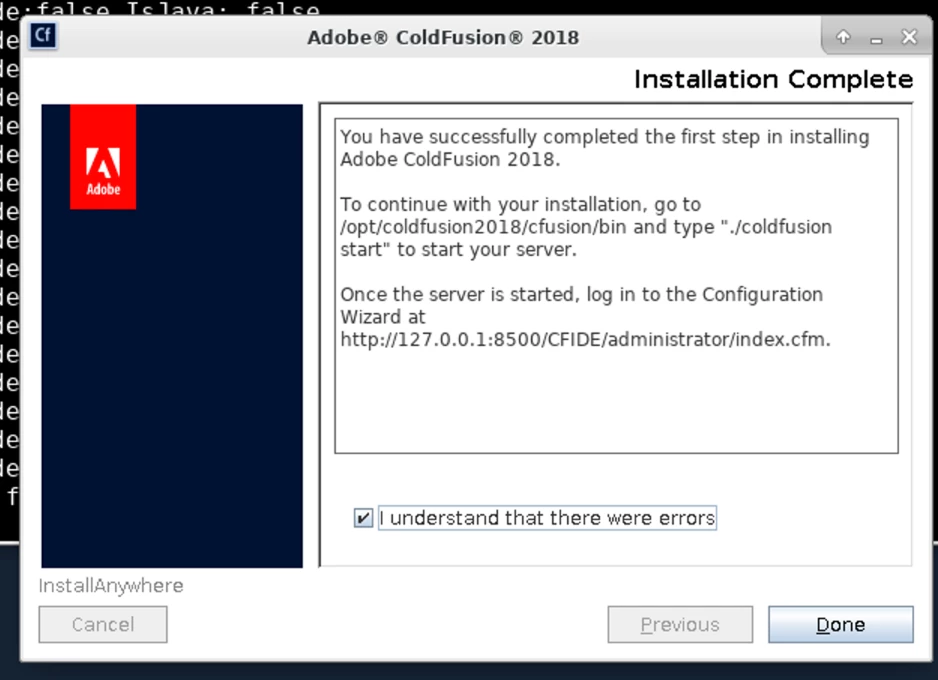

ColdFusion 2018 Enterprise application server starts then stops abruptly. CentOS 7 64-bit
I'm having an issue with a ColdFusion 2018 Enterprise application server starting then stopping after a few seconds after a fresh install on a CentOS 7 server.  for the runtime user, I used nobody, and the installation was ran under root.  I can start the application server by navigating to the opt/coldfusion2018/cfusion/bin folder and running the ./coldfusion start script.  I get a message from the terminal that the ColdFusion 2018 server has been started, but after a few seconds if I attempt to stop it: ./coldfustion stop, I get a message that the server is not running.  Also, as soon as I start the coldfusion server, I can attempt to get to the adminstrator web console on firefox on the server (127.0.0.1:8500/CFIDE/administrator/index.cfm), and it goes for a few seconds but then gives me a connection error assuming because the application server stops running.  One last thing, after the installation completes, I get a checkbox that says: "I understand that there were errors" that i need to check to click the Done button.  Are there installation log files that I can view to find the errors during installation this message is referring to?  I'm attaching this message.  Any tips/advice would be greatly appreciated.

    "WARNING: /tmp does not have enough disk space!" implies that the installation was probably incomplete. I therefore think there is no use going further with it.
    I would:
    1. Uninstall ColdFusion;
    2. Free more space in /home or specify a different directory as the tmp directory. For example:
        IATEMPDIR=/home/yourUsername/tmp
        export IATEMPDIR
        echo $IATEMPDIR
    3. Reinstall ColdFusion.

    Thank You Charlie, I'll just be adding on to the original post from now on.  Attempted to re-run installation and still cannot keep the coldfusion server running after I start it from command line.  Please see below for the message I get when I run the install.  It still completes but I'm starting to think this message is somehow related to the issue with the server not staying on after attempting to start.
    Preparing to install
    WARNING: /tmp does not have enough disk space! Attempting to use /root for install base and tmp dir.
    Extracting the JRE from the installer archive...
    Unpacking the JRE...
    Extracting the installation resources from the installer archive...
    Configuring the installer for this system's environment...
    Launching installer..."

      • 5,546 Successes, 1 NonFatalErrors: Required Disk Space: 714,429,754 Bytes Free Disk Space: 274,813,677,568 Bytes.  When I run the installation in the beginning, I receive a message stating that there is not enough space in the /tmp/ folder, so it uses my users home directory to place the temporary files.
